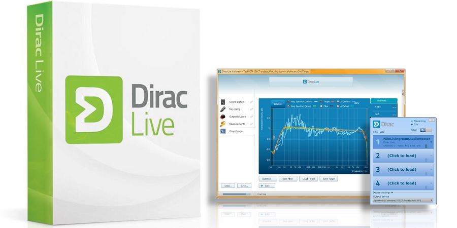

Among room correction EQ programs, Dirac Live has garnered a reputation for being one of the most effective solutions for removing the room from interfering with the sound. It accomplishes this by correcting problems with the time-arrival in sound as well as the frequency response. Other room correction equalizers ignore the time domain, but a complete solution isn't possible without addressing the time domain since latent arrivals from acoustic reflections are apart of what colors the frequency response in the first place. Let's take a brief look at how it accomplishes this, and some of the other neat features that comprise the Dirac Live package.

Actually, any eq applied to a minimum phase response aberration will simultaneously correct the phase and response. IIR filters can only address phase and frequency simultaneously, while FIR filters are capable of independent adjustments.
The problems I have with most room correction software is that they try to address high frequencys above the room transition, based on a target curve that may or may not be appropriate in consideration with the room and speakers. Think of the xcurve, many have questioned its validity, and the same argument applied to target curves at higher frequencies above the rooms transition.
Secondly, a completely flat LF response sounds wrong and is not perceived as accurate, Harman's testing discovered that most people prefer a natural amount of room gain, (about a 6dB shelving at around 60hz), when testing various DRC software, ones that targeted a ruler flat LF response when normalized to the midrange and treble were rated as thin and bright sounding.
Iirc, Dirac is said to be a whole lot better than audyssey, and I believe it allows you to customize it a whole lot more.
I'm still skeptical, unfortunately microphones simply do not discriminate the same way our ears do.

Hi and thanks for an interesting review. Based on your description, this software only works with audio files stored on or streamed through a computer since the filters are not only created but also applied in the computer. Is this right? If so it won’t have any effect on audio from CDs, Blu-ray discs, vinyl etc., so it sounds like it would be better (a more complete solution) to have a pre-amp that can receive and apply the filters.
shadyJ
Speaker of the House
Staff member
That's correct, although there are some pre-amps that have Dirac onboard too. If you want to use Dirac for outboard sources on your computer, you have to use your computer as a pre-amp, and that is do-able, with the right sound interface.

Dirac Live does mixed-phase room correction, a combination of IIR( PEQ & Crossover) & FIR filters..,correcting for both the amplitute(vs frequency) response as well the time domain response.
So you shouldnt need to add additional PEQ filters.
Shame on me, I installed the miniDSP SHD w/Dirac Live but havent gotten to using the built-in dirac live room calibration tool yet on the minidsp.., what I've done so far, is try the Dirac room correction using Dirac for Studio on my Mac at the source..,before it hits the DSP/DAC.
Dirac Studio (part of their Pro audio tools now - separately licensed) gives me the flexibility to use any DAC and not tied to minidsp or NAD etc...,Looking at the screenshots, both seem to have the same capabilities(ie Dirac Studio on Computer vs bundled in minidsp or say NAD).
I posted a couple of screenshots of what I did with Dirac studio on my Mac ,in the other thread..,but havent done much after that.
Its very user friendly...allowing you to shape the curve the way you want...not sure I agree with reviews painting it as a complex tool with steep learning curve.
