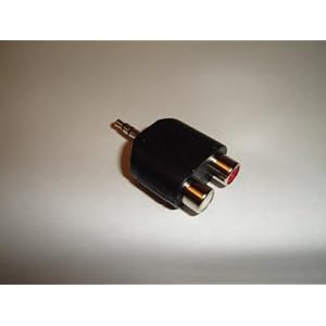

If I'm reading it right, there is a headphone jack on the bottom right corner of the TV's rear panel (next to the AV IN 2 connections). You can use that with the adapter that MDS mentioned to connect to your stereo.
If you haven't seen one, they look like this:
Hi Adam - thanks! I'll have to check the manual that came w/ this TV but not sure that was even mentioned (downloaded the online guide which seems to have more info) - BUT, I just took a look and indeed there is the headphone jack present (and barely visible) - plugged in a set of phones and could hear the sound (disables the TV's speaker as one would suspect).
I attached this connection using the device below which I had and a set of RCA cables - I then turned on my stereo's video attachment and had to turn up the sound to max for a decent level (same w/ the TV, i.e. the maximum volume is rather low, a major irritation to me) - not sure that I'll be happy w/ that choice but GREAT to know that it is available!
Now, I also have an RCA output from my new Blu-ray Sony player w/ the audio attached to the same video input jacks of my stereo and I can get a LOT more sound when playing a DVD from that new player - guess the sound output from the TV vs. the Blu-ray player are just different and that the headphone connection on the TV mirrors the TV sound output w/ these flat panel TVs?
SO, again thanks for that option found w/ headphones; it does work but the sound level is just low even w/ my stereo turned to MAX - not sure why these TV manufacturers provide such a LOW sound level output?
