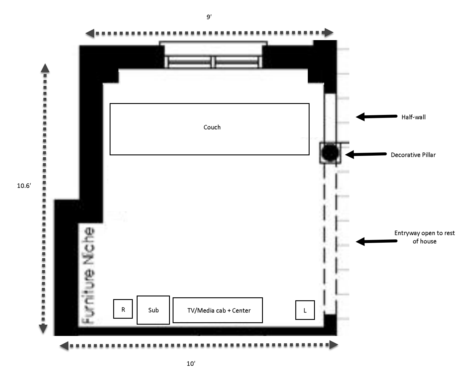

Hello everyone I'm looking to set up (ideally) a 5.1.2 system in a new home that we are moving into.
I've spent alot of the last month or so trying to figure out the set up, including the speakers/etc, and the actual setup itself.
Unfortunately, the room is certainly not ideal, but it's what I have to work with. It's caused some difficulty for me with regards to figuring out what to do with the surrounds.
The room is 9'w x 10.6'd x 8.25'h
Couch will be placed about 1-2' from back wall (which has a window with walls on either side)
There is a half-wall on one side, which ends in a pillar and then an open entry way.
With a 9' width, this doesn't leave much room on either side of the couch for surrounds. I haven't yet bought a couch yet, but it seems most of my options will result in the speakers being right at the ends of the couch. Wall mounting isn't really an option either due to the half-wall.
One thing I thought may work from my research was bipole surrounds on the back wall (the one with the window), but honestly, I'm not sure if this would work at all.

I apologize. We haven't moved in yet, so I have limited material at the moment.
I'll try to describe it as best as I can.

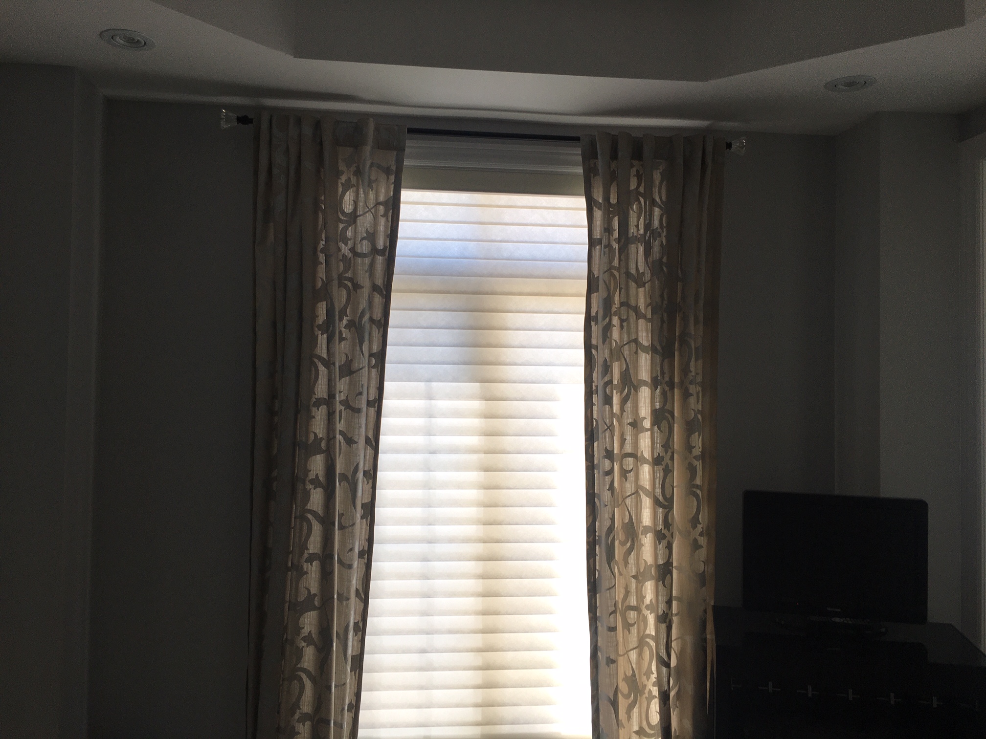

- The TV and LCR + Sub, will be placed on the wall which is not pictured (9ft wide).
- The wall opposite of that has a window with walls on either side. (this is where the couch would be, about 1-2 feet away from the window)
- One of the length walls has a 'furniture niche that is about 1' deep, but otherwise is a regular wall.

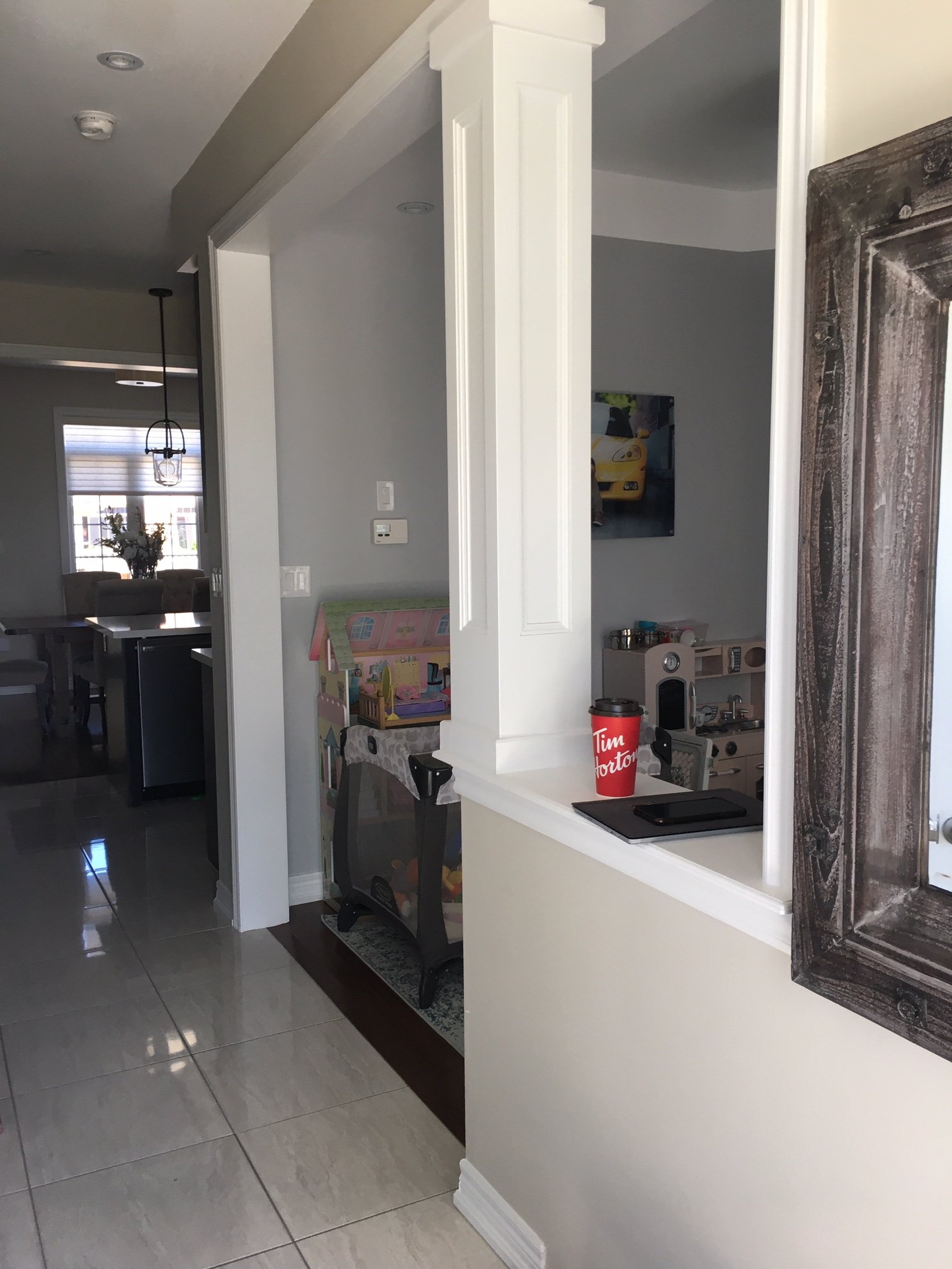

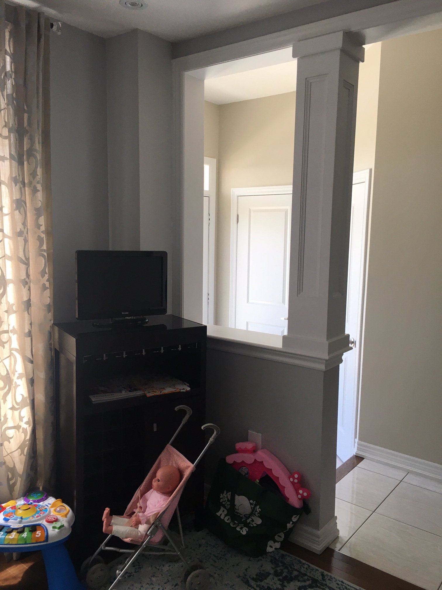

- The other wall opposite of this is the entryway (no door), which also contains a half-wall and a pillar. I have attached the only other picture I have of this side of the room. The floor plan in the first post may be more helpful, although it may make more sense if I said that the floor plan should be flipped to match the pics (this is from a mirrored version of our own floor plan)

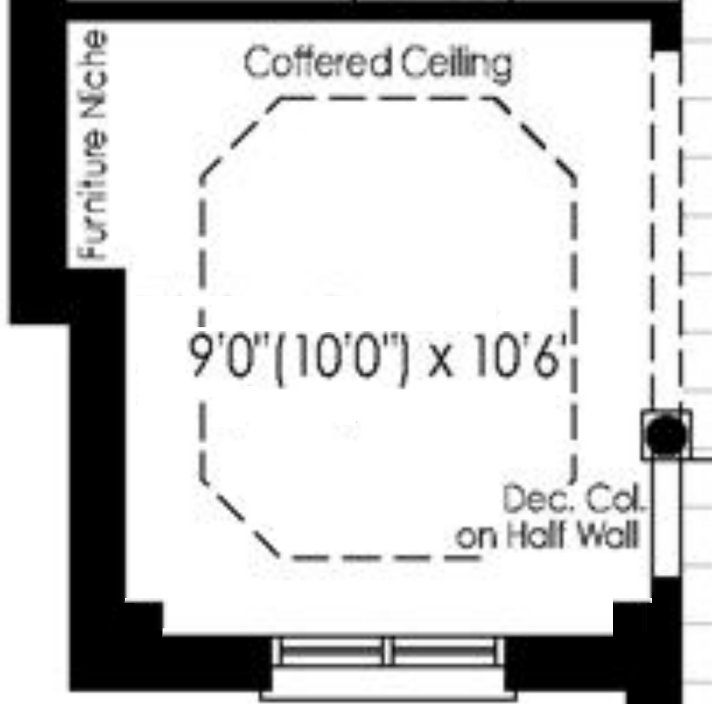

Pmasz
I have made and attached an updated floor plan that may make more sense.
