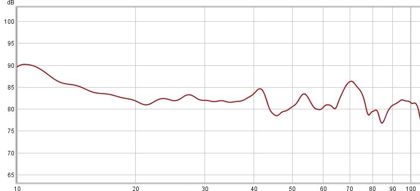

We recently received a REW FR chart from a customer using quad SB16-Ultras in a smaller enclosed room. The amount of room gain he's experiencing is pretty shocking.
In theory a monopole subwoofer can experience a room gain transfer function of 12 dB/octave starting below the modal/pressure transition frequency. But usually it's more like 8-9 dB/octave due to lossy boundaries and room openings.
Given the quasi-anechoic FR of the SB16-Ultra, I wouldn't be surprised if he's seeing ~25 dB of room gain at 10 Hz.
At any rate, this is why we design the roll-off slope of our sealed subs to take maximum advantage of available room gain.

Hi Ed, I would agree that shocking is a good word. Question though. In that same room, what would you expect the SB2K to be able to do? I would say it would be nothing like the 16, as that is a very special subwoofer indeed. Also, is there any chance of user/equipment based anomalies? Like the accuracy of his mic for example.
