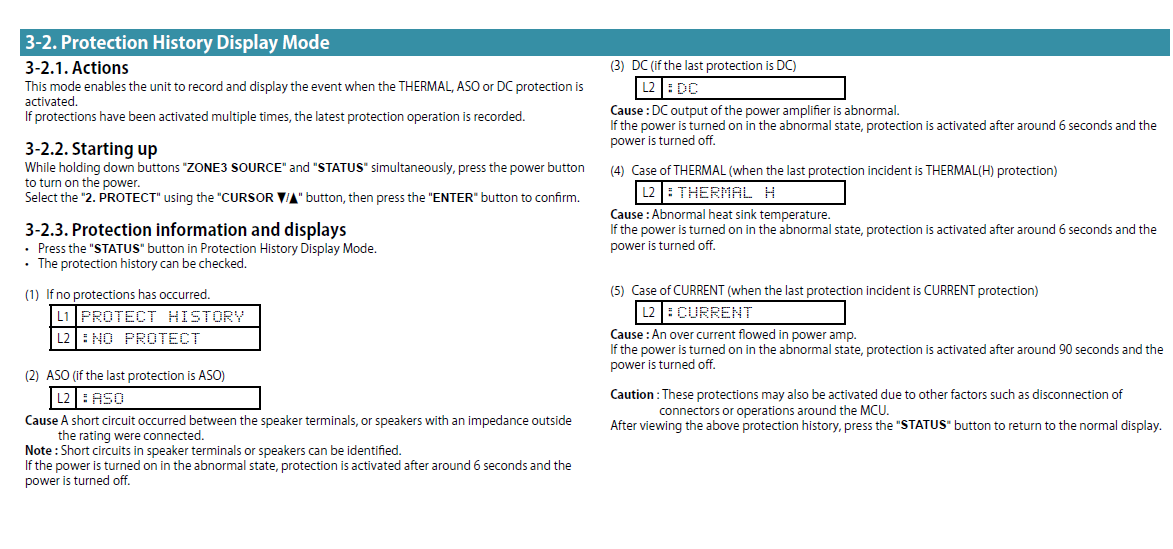

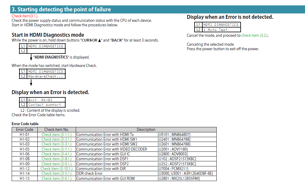

I did buy it new and I do not have any ext amps on any speakers. Last night it did it again (it came on fine but when I raised the volume it cut out) and before I hit the re-set I turned it off then back on and it worked the rest of the night. At least the standby red light burns steady now and is not flashing? I don't think it is gonna last. I have started looking around-maybe a used Denon x37000H?
Why not run the diagnostics and see if it tells you what's happening?
olddog
olddog
Well I replaced the HDMI with a new 8K high quality HDMI and thought that fixed it for about 4 hours then BANG-audio went out again after switching from BR back to Cable. Denon warranty rep started a case and Monday I will see.
