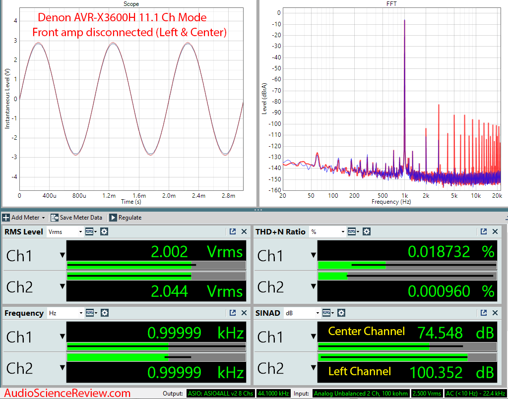

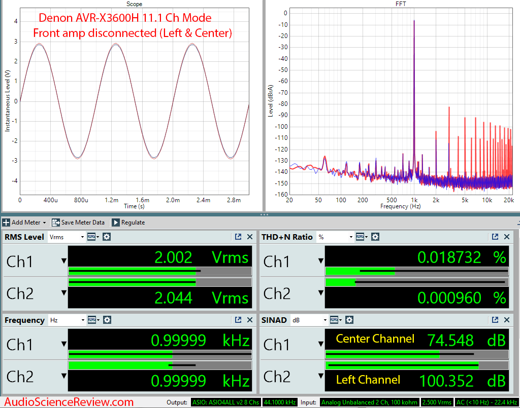

Gene, who is the first as far as I can tell, pointed out potential issue of using an AVR with external power amp is that as the preamp output level reaches about 1.2 V, their internal power amps will be close to their rated output. So at higher output levels, the power amps would clip, and the resulting higher distortions will then cause the distortions of the pre out signal to also be higher. Obviously this does not mean there is no point to add external power amps, but it does, at least on paper, partially negate the benefits of adding a much more powerful external amplifier for the expected benefits of low distortions at higher output level. Based on ASR's measurements on the AVR-X3600H, at preout level of 2 V the difference between with and without the internal power amps disconnected were not insignificant.
With power amp disconnected...............0.00096% THD+N
With power amp connected....................0.018732 %
Note that for a 200 WPC power amp such as Monolith's (28 dB gain), you need 1.6 V to drive it to its rated output into 8 ohms, and you will need 2.25 V to drive a 400 WPC power amp with 28 dB gain (quite common/typical) to its rated output. So whether without the AVR's internal amp disconnected will result in audible degradation in sound quality or not, depends on the individual user's need and whether they consider THD+N of 0.018732% for preamp is acceptable.
