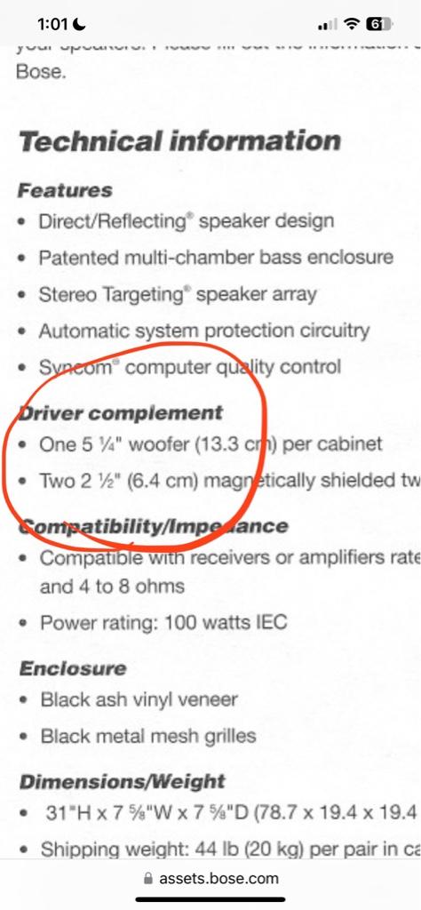

Bose 501 has a 10 inch woofer, the 701 an 8 inch woofer.
William Lemmerhirt
William Lemmerhirt
I saw a few references to the 10" woofer, perhaps depended on "version" of 501? (or was it perhaps just a PR?)
That’s my guess. Maybe a different iteration, but seems like a big enough departure to be its own line altogether. Odd…
B
bosefriendly
The 501 is a 5.25 as mentioned. Working with Audessy app to find the missing range. I would recommend a tablet or laptop with a stylus. Too touchy with fingers on a phone.
