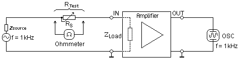

1. I'm not sure what you meant by "split"? Yes, the pre-out voltage is applied to both the internal amp and the external amp and it should be the same as long as the combined impedance of the internal and external amps are within the current capability of the preamp.
Remember the formula for calculating equivalent resistance/impedance of a parallel circuit?
From Wiki:
For example, if your Marantz's internal amp's input impedance is 15,000 ohms and your external DCA1622's input impedance is 10,000 ohms, then the combined equivalent impedance of the two amps running in parallel, that is, both being fed by the same preamp, will be:
R (consider it resistance for simpliciy) eq. = 10000X15000/(10000+15000) = 6000 ohms
That means for the same pre-out voltage, say 1.3 V the same value I used in my post #45, the pre-amp will have to deliver more current than if it is only feeding the internal amp. Based on this example, the pre-amp IC alone without help by a buffer stage (OPA, HDAM etc..) should still be able to close to 4 V (depending on the IC and the buffer/if any) so for real world movie/music use I don't see any problem.
