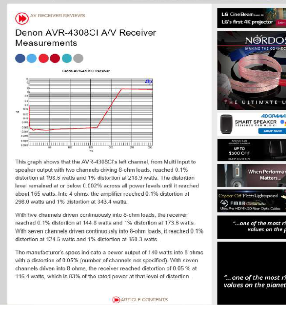

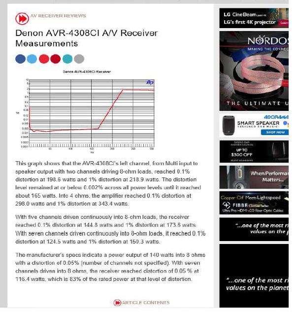

Here's the screenshot of the measurements page of that S&V review:
See that in the 7 channel test (8 Ohm), it was able to do 83% of its rated output at 0.05% THD. S&V typically used 0.1 and 1% for that test but they lowered it to 0.05%. For them to do that, they must be impressed with that amp's low distortion. I see your point about the 5308 did not do better, as the 5308 obviously has a much larger power supply. My educated guess is that all AVRs amp sections are also limited by the output devices that are typically rated about 15 A, so once you get to the 4308's level, larger power supply won't give you more output for short duration, but only for sustained duration.

audiophool7878
I am glad you ask. I found it hard to believe too at the time so I posted the link to the S&V review a few times before. It's probably two old now S&V no longer shows the measurements. I did save some screen shots though because again, I found it hard to believe. You are going to have hard time finding one that measured with more output. Just for comparison with a couple of power amps, take a look of the graphs below and see that it beats the Yamaha MX A5000 power Amp by a good margin, in both very low output level and at rated output.
In fact, you are going to have hard time finding a real power amp (Emotiva, Parasound Halo, Monolith, NAD, Rotel, Marantz etc.) that had done better on the S&V bench.
The one that came close to its output and THD+N did slightly better at below 1 W was the Marantz MM8003, but not the much newer MM8077.
Marantz MM8003

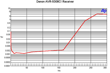

One more thing Peng if you will indulge me. You seem understand the actual math behind a lot of these stats so I'd love to pick your brain on this.
Denon lists in their manual, the 5308 power specs as follows:
Amplifier Output Details
150 Watt - 8 Ohm - 20 - 20000 Hz - THD 0.05% - 7 channels (surround)
170 Watt - 6 Ohm - at 1 kHz - THD 0.7% - 7 channels (surround)
Audioholics (and S&V) have rated the 5308 as follows:
Denon AVR-5308CI Power output: < 0.1% THD + N
  • 1CH, 8 ohms: 160watts
  • 2CH, 8 ohm, 150wpc
  • 1CH, 4 ohms: 240wpc
  • 2CH, 4 ohm 220wpc
Sound and vision rates the 5308 as follows:
two channels driving 8-ohm loads, reaches 0.1 percent distortion at 207.0 watts and 1 percent distortion at 235.5 watts. Into 4 ohms, the amplifier reaches 0.1 percent distortion at 279.4 watts and 1 percent distortion at 339.2 watts.
So as a layman, at first glance these three sets of data seem logically incoherent. If we are assuming accuracy from people at Audioholics, S&V and Denon, then how can we make sense of these three sources of data?
Denon says 160w @ 6ohm with 0.7% thd 2chd
Audioholics says 220w @ 4ohm with 0.1& thd 2chd
Sound and Vision says 279w @ 4ohm with 0.1%thd 2chd
Why such a variance across the board from these three distinct sources of data? And how can an amp that is capable of outputing at least 220w @ 4ohm with 0.1% thd 2chd, also somehow only put out 160w @ 6ohm with 0.7% thd 2chd? What gives?

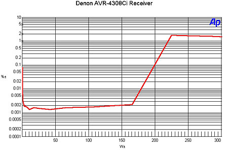

The difference in the power output measurements were so closed that I would say are within the margin of error. You can repeat the tests many times and and depending on the methodology I bet the difference would be statistically meaningless. The 5308 clearly has a larger power supply so it would do better in the 5 and7 channel driven tests. The more powerful ones are the 5805, and Yamaha's RX-Z11. According to my record, the top 10 measured (output into 8/4 ohm, 2/5/7 channel driven..) AVR by S&V were:
Ranking based on 2 channel driven into 4 ohms, 0.1% THD S&V bench tests (that's if I had made no typo, no guarantee):

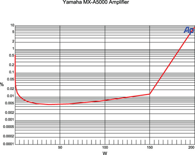

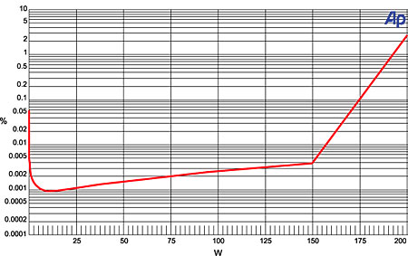

Anything I would like to mention is that different amps (even if the duts are both class AB types) may have very different power output vs THD curve shape, at the "clipping" point, one amp may have a much steeper curve than the other, and one amp may have much lower than 0.1% THD between 1 W and rated output while the other being compared may have comparable rated output at 0.1% but much higher THD at below rated output.

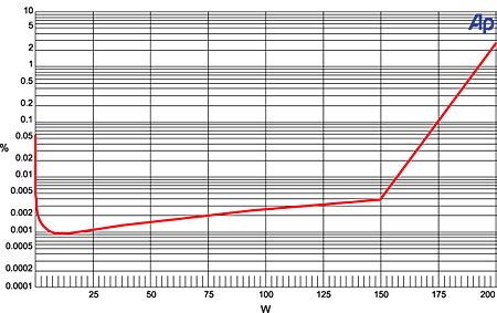

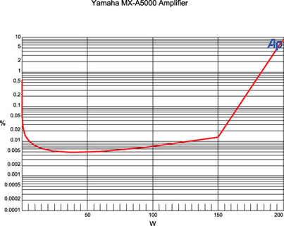

Take a look of the following examples based on soundandvision.com's on two ex-flagship avrs.:

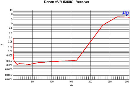

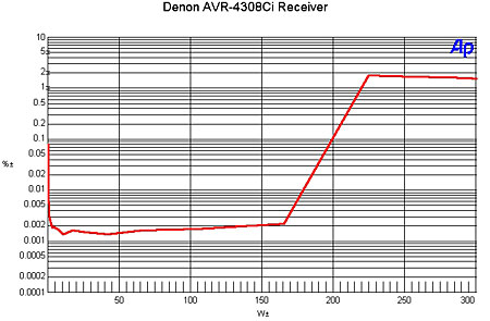

It didn't make sense to you because you seem to be mixing/comparing "specs" and "measurements". You can't do that unless the manufacturers had specified the test conditions fully.
Here's Denon's spec for the 5308CI:
Audio section
• Power amplifier
Rated output: Front:
150 W + 150 W (8 Ω/ohms, 20 Hz ~ 20 kHz with 0.05 % T.H.D.)
170 W + 170 W (6 Ω/ohms, 1 kHz with 0.7 % T.H.D.)
If you look at S&V's graph, at 0.7% THD, the 5308's output would be about 205 W, that's into 8 ohms, so it could be about 220 W into 6 ohms, compared to the specified 170 W.
That's quite typical based on S&V's measurements on other Denon models, that is, their bench measurements always show higher output than specified, by a good margin.
So again, let me emphasized, you can always compare spec between brands/models, or compare measurements between brands/models, but NOT between specs and measurements and between brands/models as it would not be "apples to apples".

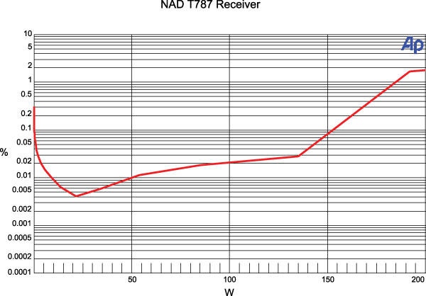

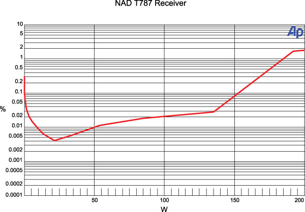

Now take a look of the NAD T758 V3:
At 0.1% THD, the graph shows the output into 8 ohms is about 101 W.
The NAD specs say 110 W 8 ohms at rated THD (whatever that means??)
So the NAD's measurements by S&V would show that NAD specified 110 W was optimistic, whereas Denon's (you will find that the same applies to most Yamaha and Marantz' higher range models) specs would seem very conservative in comparison.
I mentioned this because there seem to be some die hard myths that NAD, Arcam, Anthem, the kind of boutique branch (add HK back 10 years ago) published power output specs that tended to be conservative, relative the Denon, Marantz, Yamaha, Onkyo, Sony's etc., when in fact if you look at the bench measurements from S&V, AH, HCC (no longer exist), and now ASR, you will see that the opposite it true. That is, D+M, and Y's are actually much more conservative, so much so that if you compare their specified outputs to bench measurements, they would in fact not make any sense to you.
NAD T758 V3 A/V Receiver Review Test Bench | Sound & Vision (soundandvision.com)
I hope this is now clearer to you, why those numbers don't make sense to you.
