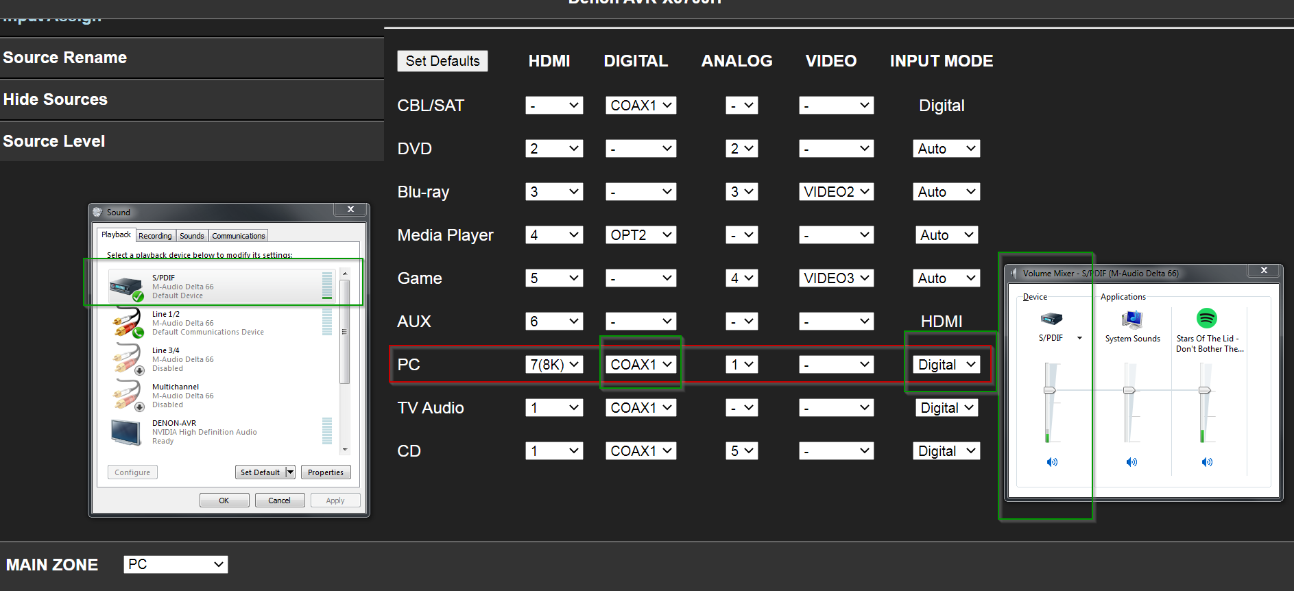

Can you take a picture and post it here, of your input assignment screen? I have to feel this is an input assignment issue. This would be a strange but not a totally improbable fault. If the inputs are assigned correctly, then that receiver is faulty and should be returned.

@TLS Guy Thanks, here's a screenshot from the web UI. I also included windows showing that the digital output is selected as default playback device and that it is playing audio. I've also tried other HDMI inputs instead of the 8k input with Digital set to Coax1 (and Coax 2 just in case maybe the one port was bad) and Input Mode set to Digital.

From the screenshot you have had multiple input sources assigned to COAX1, try assign just one at a time and see if it works on one or all of the inputs if only one is assigned to COAX1 at any one time.

Thanks @PENG and sorry for the late reply, but I had already tried just using COAX1 a single time to no avail. Assigning inputs multiple times is supported too, but tried just the single one for testing purposes anyway.
