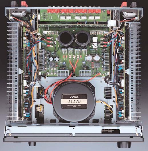

I wouldn't write it off completely just yet. Did you take the bottom cover off and check those fuses too? I could tell you to check certain components if I had one of these in front of me but I don't so I am just going by the pictures I can find online. It looks like a relatively simple to repair unit if we are talking just the output stage.
I think this is the internal view of that unit.
If the problem stops with the power transistors, that is one thing. Sometimes it does, sometimes it does not.
Even so those power amp boards are pretty crowded, so you would need know how to find your way around.
Personally, I don't usually get very far servicing gear like that without a circuit diagram and better still a service manual.
I can't find either on line.
I doubt this is a fuse problem as the protection relay is cycling, indicating the power transistors are getting power, but shorted, with an excessive collector to emitter current draw. The relay is protecting the power supply.

Yeah that's it...I know I'm at a crossroad here...I can look around and try to locate more fuses but circuit board repair is beyond my experties
Haoleb
Haoleb
I did see a photo of a unit with the bottom cover off and there were multiple fuses there. Not certain that was this particular one but its worth a check. You may also be able to un plug the cable connectors going to the board that has the suspect channel and get it to power up and possibly even work with the other channels.
