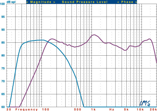

Thanks for the link. That be the beast in all of its built-like-a-tank glory. I worked up a new crossover that pretty much flattens things out without breaking the bank. There's no way to fix things without using two inductors (a series for the woofer, a parallel for the tweet), and that's the main cost. You can use electrolytic caps and Datyon resistors, with a total cost of around $20 per pair. It's obvious why Dayton didn't do that, but you will end up with a very netural sounding speaker for $50 a pair at the sale price, $60 at the regular price. Plus, there's room to work inside the cabinet, so a mod isn't all that difficult. There's still not much bass, but sitting them on a flat surface rather than a stand might help that out a little. And it needs a
cabinet full of poly fill rather than the paper-thin sheet it currently uses. That will add a slight amount of bass and cut down on internal reflections. Here's the new response. I'll probably voice the highs down a little to compensate for the thin bass, but that's just a matter of a resistor value.

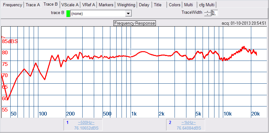

I actually ordered me up a pair. With my wholesale pricing and the sale price, they cost less than the PE speaker wire I've been using. The main reason was to check my measurements against John A's. That should make a good reference point to make sure my measurements are accurate, subject to sample-to-sample variations in the Dayton speaker. But I'll see whether there's anything cost-effective that can be done to smooth out the response and deaden the cabinet.
Well, the measurements seem to be subject to Hurricane Sandy.

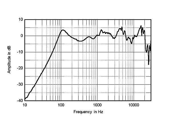

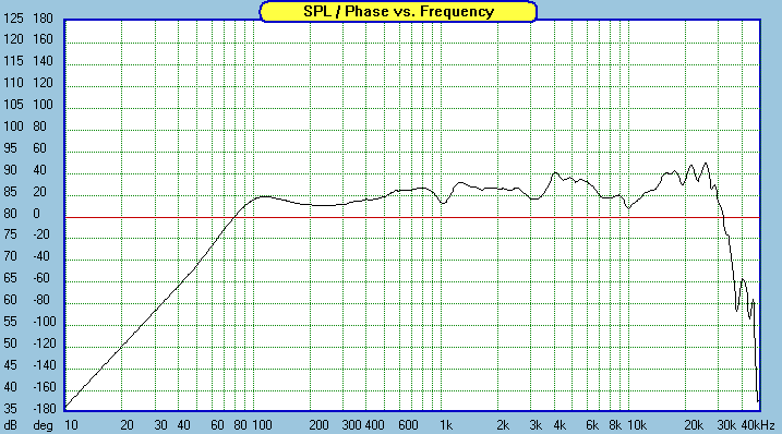

In order, here are Stereophile's, Zaph's, and yours.
Zaph said their measurements were done on axis, halfway between the woofer and tweeter. Atkinson didn't state how his were done, but there seems to be reasonable agreement with Zaph's. The measurements are quite different even trying to mentally adjust for the scales. If your stated goal was to SP's as a reference in part to check the accuracy of your work, how should the reader interpret the differences?
Dennis Murphy
I can't really explain the difference, except to say that both of mine measured identically, and it couldn't be due to a mic calibration problem. When I measured the tweeter running free without the crossover cap, the maximum output was 8 dB below the woofer breakup peak at 4 kHz. So there is no way the tweeter could attain the output shown in the other two sets of measurements, because the woofer runs free. Plus, they sound exactly like they measure. I'm constantly checking my measurements with Jim Salk, and while they may differ by a dB or two at the very top, there's nothing that could explain the difference between my measurements and, say, Stereophile's. I took this plot on the tweeter axis, but going further down or off axis horizontally didn't really help. There was a little less cancellation between the tweeter and woofer when I measured nearer the woofer axis, but the woofer peak got higher (as it naturally would). I also tried backing up to the maximum possible mesuring distance (around 50"), but it was still the same banana. If I get a chance, I'll try and get a measurement using the Parts Express mic and software. But I've always got reasonable agreement in the past.
it could be the equipment JA is using which could have some diffident inherent characteristics towards his measurements : "DRA Labs' MLSSA system, using a calibrated DPA 4006 microphone to measure the speaker's frequency response in the farfield, and an Earthworks QTC-40 mike for the nearfield responses."

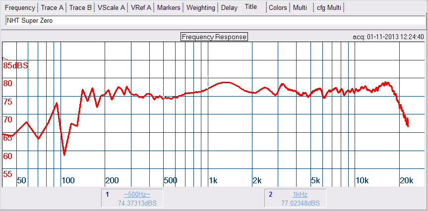

As a reality check, I just shot this on-axis plot of the latest version of the NHT Super Zero. I'm pretty darn sure this is an accurate representation. NHT voiced it flat, and if my mic started to do weird stuff above 5 kHz, NHT must have a real dog on their hands for it to measure flat on seriously defective equipment. Speakihg of dogs, my PE mic seems to have acquired a strange rattling noise after its last trip out to the back yard in my retriever's mouth. I'll still try and get the PE system up and working, but I can't swear to the accuracy of themic at this point.

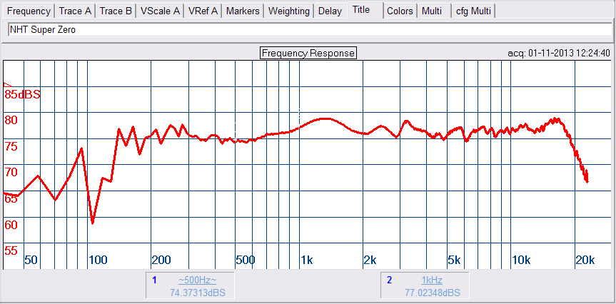

Here is HTMag's measurements of the SuperZero 2.0 for comparison. I don't know if this is the same version though, Dennis.
Dennis Murphy
Well, there does seem to be an issue with my tweeters, since we now have 3 different measurements showing the top of the tweeter response even with the woofer peak. That bothers me. I'm sure it's not my measurements, but that leaves me not knowing what the true speaker is like. If you ramped up the level of my tweets 4 or 5 dB, you would basically match the other measurements. Very strange. Could they have switched tweets? I may write to PE.
I understand that both of yours measured identically, but it's quite amazing that Zaph & SP appear to be in closer agreement and that with being done a few years apart. I'm not trying to call you out Dennis, I hope you understand that. I'm looking for reasons. A few that come to mind, and by no stretch of the imagination am I an expert here, are as follows...
Could it be that the microphone was positioned differently in your case? Zaph says he measured midway between the tweeter and woofer but IIRC, he didn't give the distance. Don't know about SP but what about you?
