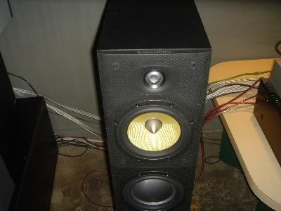

Hi Guys
A few weeks ago my I left my speakers grilles off because I had some friends come over and showed the speaker to them , next day my 2 year old gets curious and decides to poke on them damaging 1 of the tweeters!!!
I’m sure I don’t have to say that I almost had a heart attack when I saw what happened
I contacted the dealer and explained the problem couple of weeks later the fine people at B&W sent me a replacement free of charge!
Thing is that I can’t figure out how I should open the speakers , the tweeters are covered and don’t have the screws showing and not quite sure if removing the mid speaker will help me see inside.
Does anybody know how I should proceed with this I don't want to take the speaker to the dealer because it's a 3 hour drive from where I am.
Any help will be appreciated
Thanks!

I would first check to make sure that the speaker can be removed from the front of the baffle if not remove one of the speakers the speaker may be mounted with screws or mounted in a adapter if you feel this is too dificult I would give the speaker manuf. a phone call if they sent you a replacement then it must be a simple job to replace it but please be careful with screw drivers I would call the manuf first before doing anything

I took a look at mine, and it looks like it shouldn't be too impossible. Pull out the little rubber plugs in the holes where the grill posts stick into the baffle. There are screws behind those. Those should remove the whole front, and I would expect that the tweeter is mounted onto the baffle from the inside. Good luck.

Success!
i had to remove the mid speaker to be able to remove 4 hidden screws that hold the front plate and from there it was just plug & play
My speakers sound great once again!
Thanks for all the help!
