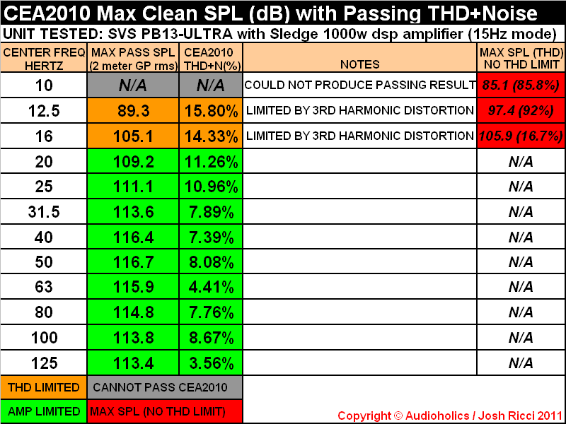

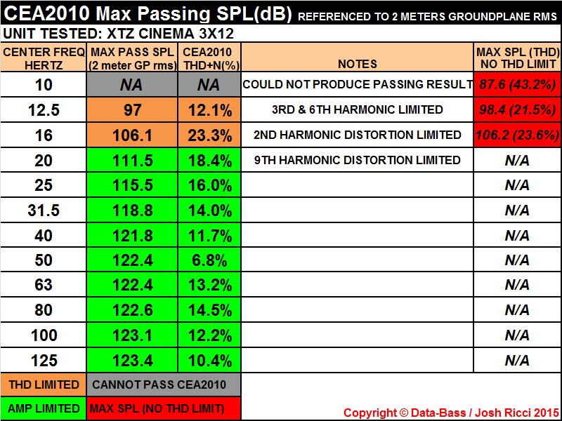

Hopefully not a silly question to ask - The Dali Rubicon's goes to about 38 Hz before they reach -3 db, so I plan to kick in the Subwoofer at 40 Hz or so - and thus can play it 'louder' while still being right level to match the stereo speakers. (I read this tip at a different subwoofer guide) - that way the output of the deeper bass is cranked up a bit.
The question is: if pb13 at 40hz does 116db - while 3x12 does 121db - can't I when listening to the pb13 crank up its volume as the 40hz volume should be a certain value to match whatever the stereo speakers are playing.. and if the 40hz of the pb13 is leveled with the one of the 3x12 - that would actually make the pb13 curve surpass the one of 3x12 as it declines slower (until that 12,5 mark that is - where pb13 is dead)
shadyJ
Speaker of the House
Staff member
You will want to cross the sub to the speakers at around 80 Hz. Your speakers may be able to play down to 38 hz, but they will not do so nearly as well as a subwoofer. Their response will be down quite a bit before that point, and they would struggle to play down in that bass region with authority. By crossing the speakers over higher, it takes a load off of them and you end up with a cleaner sound overall. Your speakers can not play bass down that low nearly as cleanly as the subs. Your AVR will level match the subwoofers to the speakers, so you do not have to worry about that (as long as you have a somewhat modern AVR, and you do).
As for the respective curves of the subs, your AVR will shape the curve more so than the subwoofer. The room will also impact the curve too. The room will likely boost up the low frequencies a bit. The equalization routine on your AVR will correct any frequency points where the room boosts the bass too much ie summations. Both the PB13 and 3x12 will play very deep, but the 3x12 has the potential for more deep bass, as it more than doubles the deep bass output of the PB13 at 12 Hz. So, yes the PB13 would produce more deep bass at normal listening level, but not if you use Audyssey. Your AVR has a very nice implementation of Audyssey, I suggest you use it.
