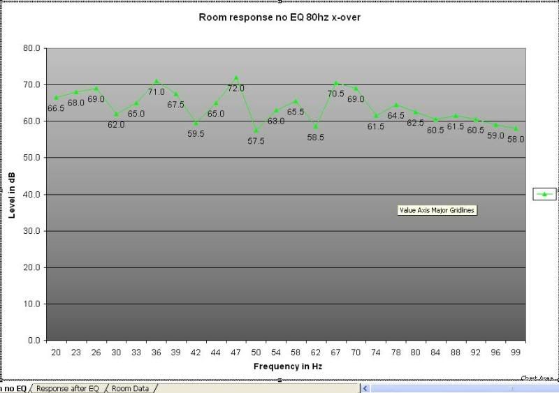

Well we got everything installed this weekend. Results so far are very promising. My friend's room is not completely finished which affected things slightly but overall things are going well.
Below I have a response graph from the primary listening position, taken at lower levels (approx 30db below reference output on the receiver).
Here is a "rest of" system breakdown:
Receiver: Onkyo TX-SR707B
Speakers: 3 - Kef Ci200.iQs (front & center) and 4 - Kef Ci200.iQr (rears)
I did have a hiccup however using the feedback destroyer. It is adding a hum to the system. By passing this component completely eliminated the hum. It appears to be a ground loop at this point. Due to this issue we have not attempted any room correction at this point though I can see where the problem areas will be.
The peak in response at 45-47hz muds up response, so getting the eq implemented is a priority.
I also did not do a 3 position average for response yet either due to the room being incomplete. We will do more tuning.
Just for fun, I did run the system near reference level with a 23hz tone 10 ft. from the sub. In room output at this level yielded 102db!! This literally shakes most of the house!! The best part is that the enclosure barely has any vibration protecting the joints from cracking in the wall.
Not bad for dual 8 inch drivers and a system that is designed for output above 25hz!!

That doesn't look too bad so far. I was wondering how much vibration would be transmitted and if the plaster would crack. Good luck with the ground loop and equalizing. I'll be following your progress.:)

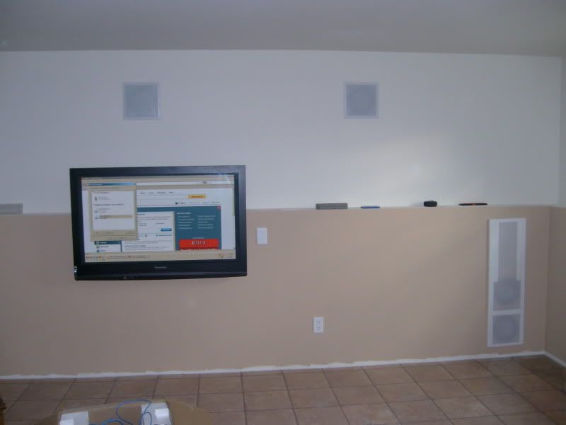

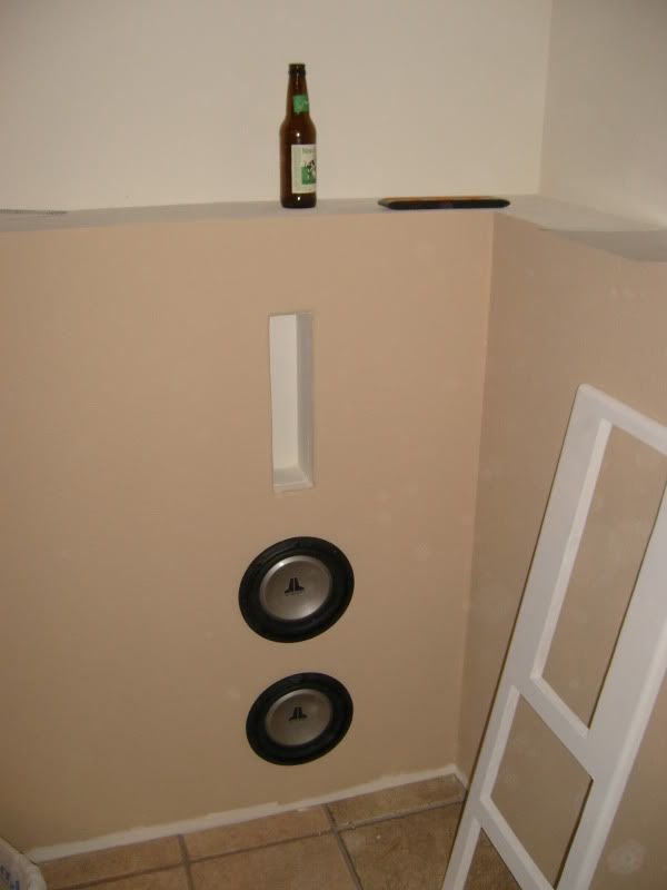

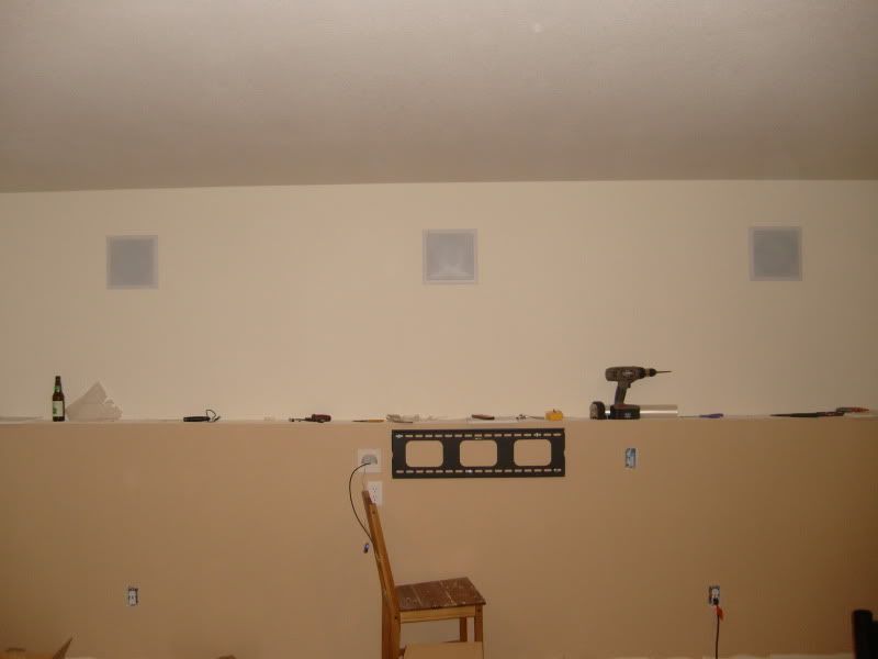

Here are some updated pics I finally received.
Speakers in with bracket installed for TV:
Here are the subs installed into the enclosure:
Here is a shot of the speakers installed and the sub grille installed:
Lookin' good! I don't know why, but I had been thinking that it was mounted in a side wall. Apparently, I was mistaken...

Nice subs but I have to USK because I had the same drivers there car subs??
96cobra10101
96cobra10101
Yes, their car subs, non vented. You have to read through all the post, but its there. Pretty cool design BTW.
