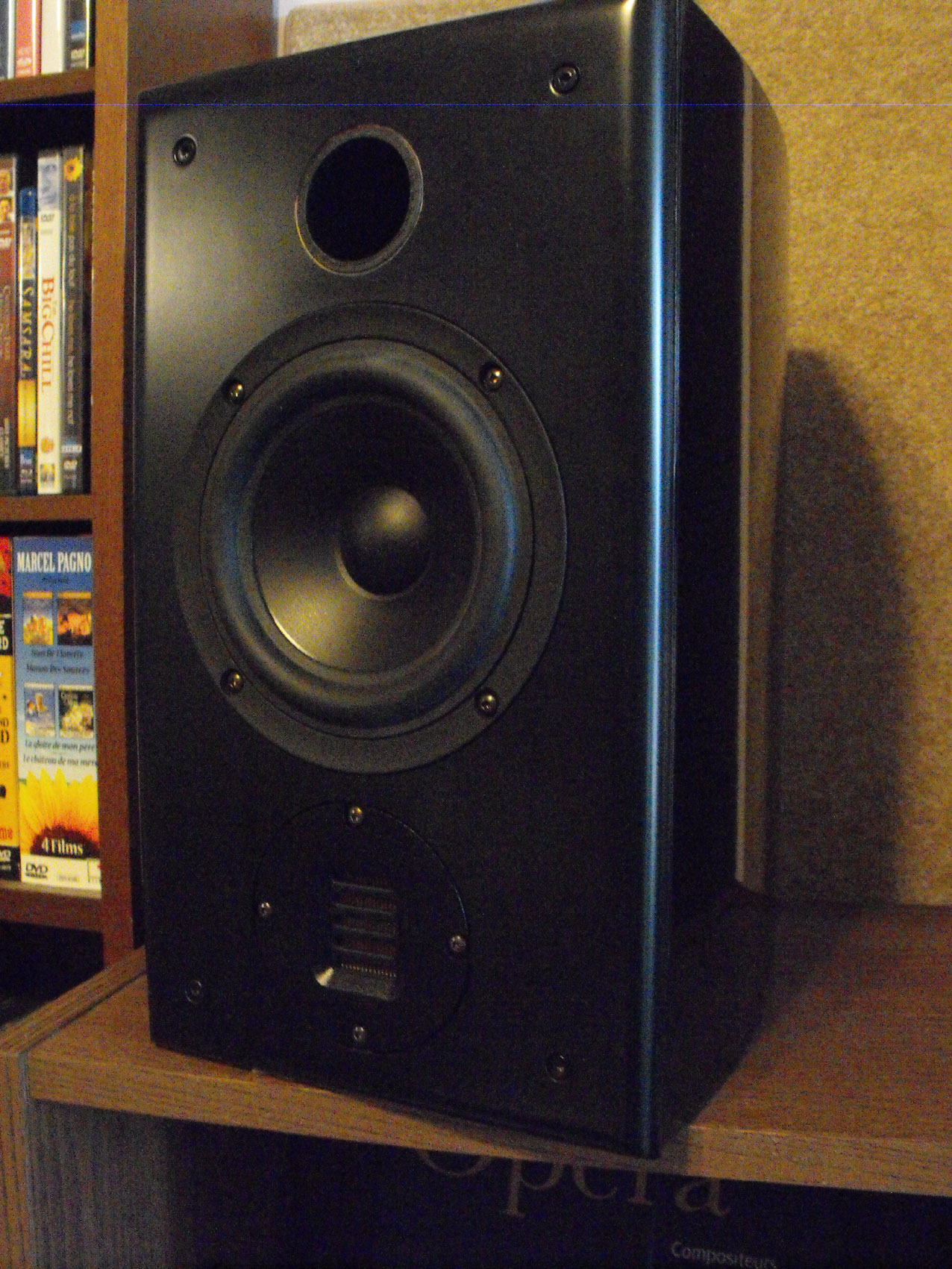

In your situation, a 5 inch woofer is all that would be appropriate, but you could put two of them in same cabinet to gain more headroom and power handling. The 5 inch drivers below can fit into a cabinet with a net volume of 22 liters only. A matching dome or air motion ribbon tweeter could complete the system.
Are the SB Acoustics speakers available in Australia? That company manufactures excellent very affordable speaker drivers. As a matter of fact, I built several bookshelf enclosures using one of their SB15MFC30-8 and its response
in a properly tuned ported cabinet can reach low frequencies down to below 50 Hz easily. Then, if you find the need to obtain a fuller bass response, you could eventually add a subwoofer or two to complete your system.
Should you need to import them, the advantage of lighter small drivers means cheaper shipping costs.
I have included a photo of one of the bookshelf speakers which I built a couple of years ago. In my HT system, I use four of those as surround and surround back speakers.
To succeed with a DIY project, you need at least to know the basics of good cabinet construction and to have some knowledge of loudspeaker functioning, passive crossover construction. It is also a must to have speaker testing equipment to be able to properly tune ported cabinets, and to build passive crossovers with the components that are matched to the drivers to be used.
Should you wish to import the SB Acoustics drivers with matching tweeters, let me know and I will provide you with the info for a reliable seller in the Montreal area who could supply you with all the quality components including crossover parts and schematics to complete good speaker cabinets. That is the firm I deal with for speaker components. They ship worldwide.
In any case, I wish you the best with your project.
Are the SB Acoustics speakers available in Australia? That company manufactures excellent very affordable speaker drivers. As a matter of fact, I built several bookshelf enclosures using one of their SB15MFC30-8 and its responseView attachment 29153 in a properly tuned ported cabinet can reach low frequencies down to below 50 Hz easily. Then, if you find the need to obtain a fuller bass response, you could eventually add a subwoofer or two to complete your system.
