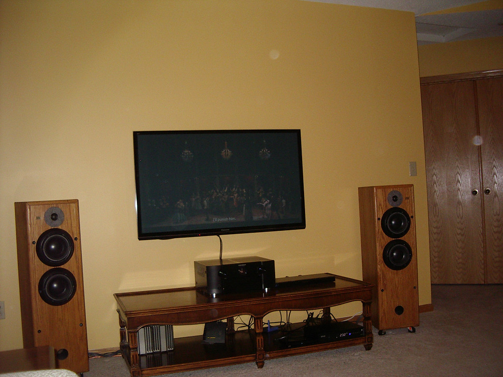

So that is why in my reference system I have designed an integrated full range speaker system that does not require a sub.
When I do use subs I design the speaker and subs as an integrated package designed to work together.
Let me show you what I mean.
These speakers have four compartments. Below the tweeter is the bass/mid in one sealed cavity. Below that is the BSC driver in its own sealed cavity. In the box are two 9" sub drivers in isobarik configuration. It is a band pass sub, with one sealed and one vented cavity. The 3db points are 27 Hz and 90 Hz. Roll off is second order. The bass/mid and BSC speakers are designed with a 3db point of 90 Hz and since sealed roll off second order. So there is an acoustic crossover at 90 HZ.
Now interestingly, i was able to get the Marantz pre/pro to duplicate the electronic crossover I built for these speakers. Now band pass subs have a slightly peaked response. So the crossover is symmetrical by setting the high pass crossover to 60 Hz, so the woofer slopes are second order (12db per octave) acoustic from 90 to 60 Hz and then fourth order (24 db per octave) combined electrical and acoustic slopes below 60 Hz.
Now the sub rolls off nicely second order above 90 HZ and to prevent HF radiation from the port the LFE low pass was set to 120 Hz.
