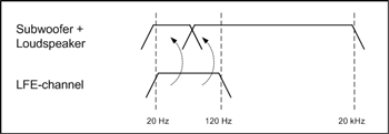

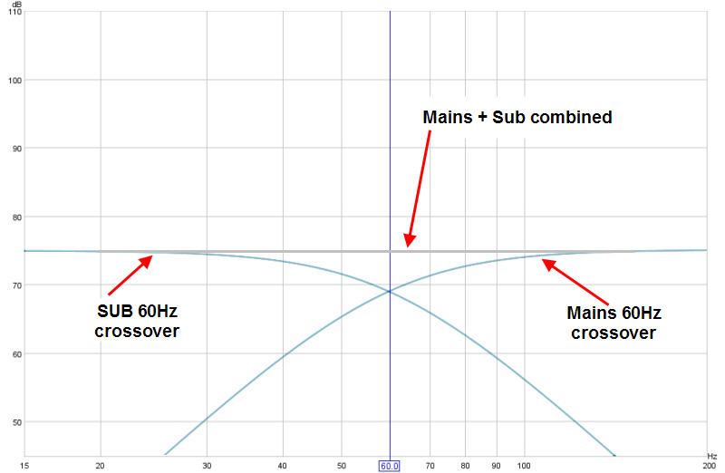

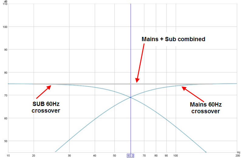

Sorry I was too quick to respond, and you are correct that the satellites were measured separately. So the graphs show the -6 dBpoint is 45 Hz. However, the fact that the -3 dB point is 150 Hz, YPAO did pick a reasonable point of 110 Hz. Hard to know what his in room response it, so there is no harm trying a little lower, say 100 Hz, but without seeing the in room response curves, it is safer
I think 120 Hz is a good bet. How far do you sit, and how far are your speakers and sub from the wall?
Generally speaking raising the crossover to 120-150 Hz will in fact put more bass to the subwoofer and allow the satellites to be more at ease focusing more on the mid bass that they are designed to handle. The only drawback would be localized bass, in a smaller room that should not be an issue unless you set the XO point even higher than 150 Hz.

As far as various levels for your speakers, they're basically an adjustment made to provide the same level at your seat, and would be based on the mixture of the speakers' sensitivity and distance from your seat. If you can't tell a difference at 110 I'd just leave it there (and yes, this puts more of the work on the sub at 110 than if you move it lower, which would shift the "load" to your speakers).
