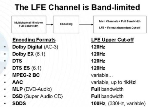

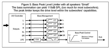

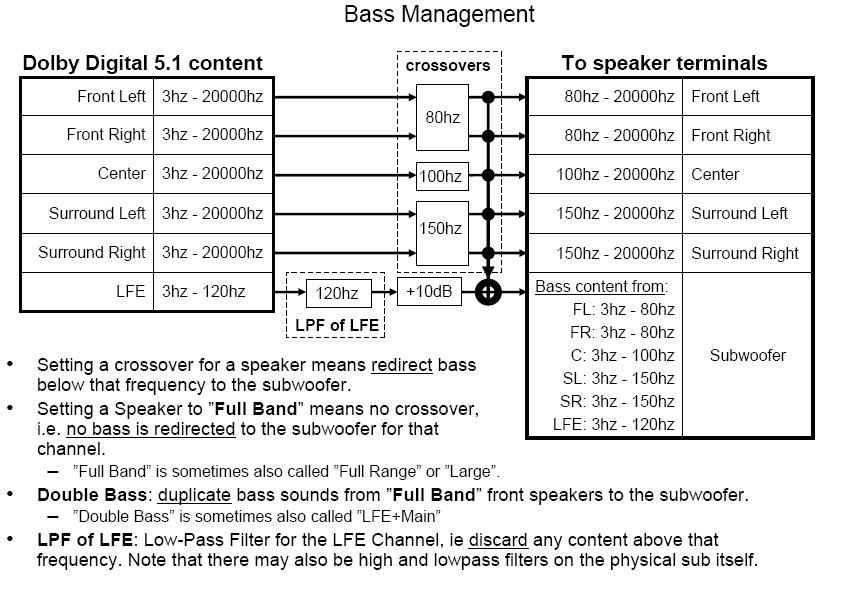

Being a graphics guy I thought some images might help. Let me know if you find these to confuse you further. I hope it makes it easier.

I maybe didn't mention that the xo won't effect the LFE channel, but it WILL still effect the other channels, just as in stereo playback. Am I making sense? Did the images help?

The picture helped to an extent (the first image didn't really make sense to me)
Excellent! Also if I remember correctly, in the image you posted, the XO was set to the lowest point(40hz?) and the line in input connection was used so by changing those things an running ypao again, a lot was changed.

The image is fully complete.. thanks alot my friend

The first image is actually the simplest to understand. Imagine both sets of lines as one track. The top set(2 lines) shows how the XO works. From 20-80 is the subwoofer range and from 80-20,000 is the speakers range. The reason for the sloped lines at the ends are how the filters actually work. A XO does not stop all frequency information exactly at 80. It's a gradually descending reduction of 12 decibels per octave on either side. The lfe image is what's present regardless of subwoofer+speaker content.
