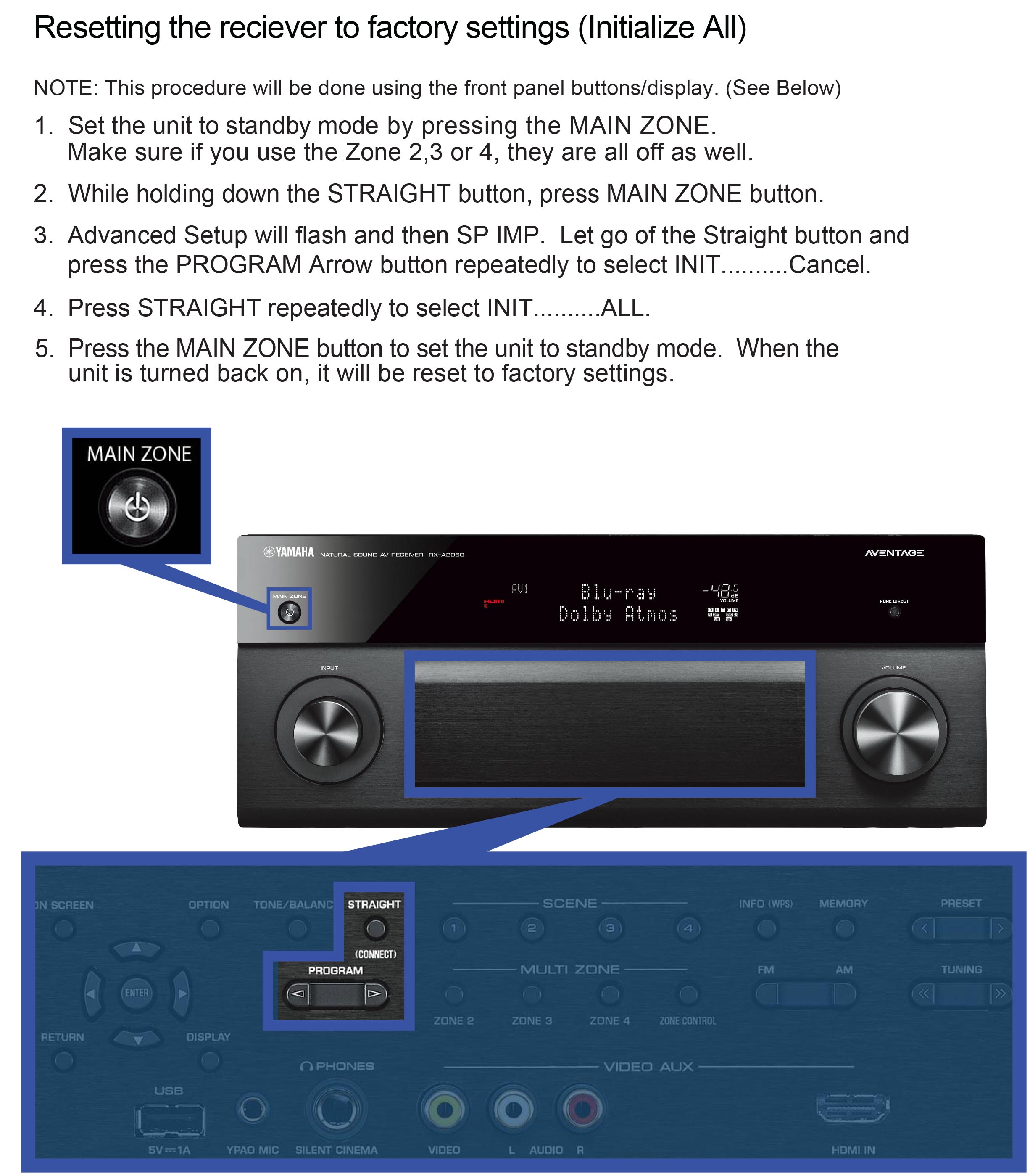

lovinthehd Audioholic Jedi Sep 11, 2012 44,868 0 113 Oakridge, OR Nov 22, 2017 #643 Hasan Alnajdi said: I am not sure really .. the setting we did before with you are all gone .. but did reset everything else I have no idea.. even ypao reading are gone .. I tried to do the setup again but due to speaker failure it didn't complete and run Click to expand... Try this http://faq.yamaha.com/us/en/article/audio-visual/aventage/rx-a2060_u/11053/9315 Reactions: Pogre
Pogre Audioholic Slumlord Jul 29, 2016 16,146 0 113 56 Mesa, Arizona Nov 22, 2017 #644 Hasan Alnajdi said: this is the section for restoring the default settings in the avr ... as you can see they don't say much Click to expand... Here's a link on what to do to do a reset. If you already did, I'm tapped out.

Hasan Alnajdi Full Audioholic Mar 29, 2017 367 0 28 47 Nov 22, 2017 #655 regarding step 5.. should I sit and wait for the avr to start automatically or should I turn it on by my self??
lovinthehd Audioholic Jedi Sep 11, 2012 44,868 0 113 Oakridge, OR Nov 22, 2017 #656 Hasan Alnajdi said: I did it exactly like that.. should I do it again in your opinion? Click to expand... It wouldn't hurt. If it's only happening on airplay did you try resetting the applish device(s)?
Hasan Alnajdi Full Audioholic Mar 29, 2017 367 0 28 47 Nov 22, 2017 #657 lovinthehd said: It wouldn't hurt. If it's only happening on airplay did you try resetting the applish device(s)? Click to expand... I can't clean install my iMac for there are a lot of reinstalling to do.. but the iPhone I did reset and the same issue remain
Hasan Alnajdi Full Audioholic Mar 29, 2017 367 0 28 47 Nov 22, 2017 #658 I tried initialize again and I am waiting now for the avr to start up how long do you think it should take to reset??
lovinthehd Audioholic Jedi Sep 11, 2012 44,868 0 113 Oakridge, OR Nov 22, 2017 #659 Hasan Alnajdi said: View attachment 22932 regarding step 5.. should I sit and wait for the avr to start automatically or should I turn it on by my self?? Click to expand... Sounds like after it is complete and returns to standby mode then the next time you turn it on (from standby that is) it should be reset to factory settings....
Hasan Alnajdi Full Audioholic Mar 29, 2017 367 0 28 47 Nov 22, 2017 #660 lovinthehd said: Sounds like after it is complete and returns to standby mode then the next time you turn it on (from standby that is) it should be reset to factory settings.... Click to expand... but it returned to standby state immediately after I hit the main zone.. could it be that fast to reset ?
