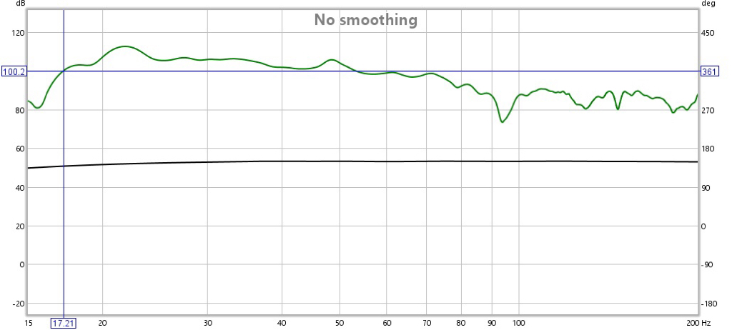

Yes. In this case it would have. In this case the sub is designed to play flat (anechoic) to 35(can't see the post). The -3db decibel point is where the roll off slope is at -3db and the subwoofer loses meaningful output below. Generically speaking, ported subs roll off at a rate of 24 db per octave(of descending frequency). That protects the driver from unloading and bottoming out below the tuning point, among other things. Fwiw sealed roll off at 24 db per octave.
In this picture follow to the left, and as the frequency drops, you can see the output does too. There is a calculable slope that it follows to the point of no useable output from the -3 point and below. Now I must make some coffee as to be able to put my words in better order...

We'll use this pic to look at upper and lower-3. As the ends taper down, you can imagine where -3, -6 etc is. Iirc, 3 decibels is where humans discern a difference in loudness. So when they say +/-3db across the frequency range of a speaker, that means from its lowest to highest frequency response, it plays from the baseline, plus or minus 3 decibels. Basically it's a level of tolerance. Upper and lower -3 points just show what the highest or lowest useable output is.

It basically means after 32hz, the output from the subwoofer will be less, and less as frequency drops. Fwiw, 32hz is really high for an ht subwoofer. Some movies have been mixed with filters around 30hz but they sound weak and boomy. 20hz is a good enough place to start rolling off. I'll use this pic again (just to keep you from searching). It's useful to about 17hz and will shake your butt, and everything else.
