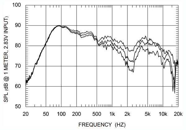

That's the big one for Reaction's application. Normally you wouldn't want to try and cross a tweeter over to a 10" woofer. Above say 1kHz, said woofer will start to beam noticeably, i.e. its dispersion will narrow. In addition, cone breakup won't be too far behind, requiring additional work to solve. Now that's far too low to cross over a conventional tweeter, and the end result is that the off-axis FR will exhibit a large dip, along with any nastiness associated with inadequately controlled driver breakup. You can see an example of such a dip with the measurements of the Harbeth Model 30 Domestic, which utilizes an 8" woofer and 1" soft dome tweeter:
The Reaction CX-10 attacks this from both sides:
1. They utilize a relatively large 1.75" compression driver that can go a bit lower than a run of the mill 1" tweeter.
2. The concentric arrangement serves as a waveguide to the tweeter, narrowing its dispersion pattern.
The end result should be a relatively smooth off axis response that declines as the frequency goes up.
