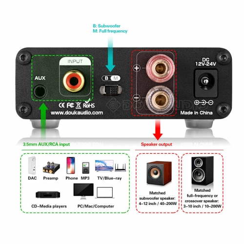

The amp is an external one, a Douk Audio G4

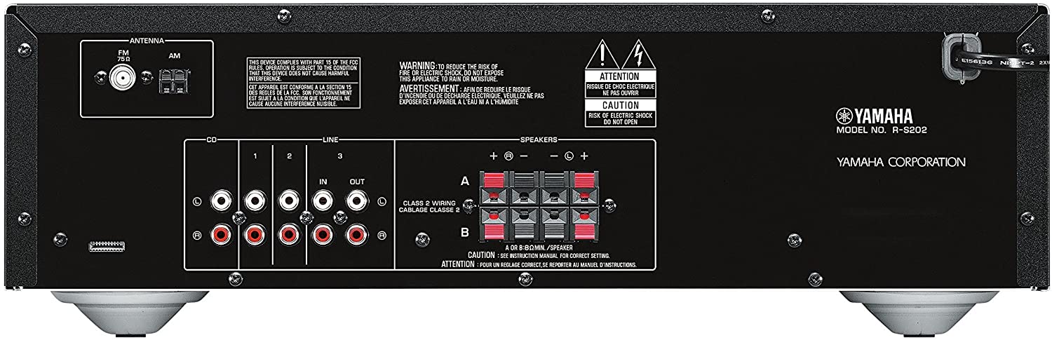

Receiver:

So the receiver does not have a subwoofer connection, I used a singe bass cable from the Douk to the receiver and left the Right connector unconnected... hopefully that makes more sense. New to all of this, guys! Entry level stuff!

What output on the receiver are you using to connect to the amp? While most bass is essentially mono in sub range, still better to use a stereo connection if the Douk amp can sum it to mono.....

ps Now that I look at the back of the amp it doesn't appear to be capable of such as it only accepts a mono input.

Your three pieces of equipment are NOT compatible with each other.
- The SW-15HT lacks high-level outputs.
- The Douk amp lacks stereo inputs.
- Per online BB specs, the Yamaha R-S202BL lacks sub out to feed the Douk or L/R pre-amp outputs to feed a powered sub.
Best bet; get an inexpensive powered sub that has high-level input/outputs and return the Douk.

The SW-15HT I looked at is a simple passive sub with normal speaker terminals. Am curious what output on the Yamaha he's using, tho....and not sure if the Douk can sum to mono if you use the aux input....otherwise appears to be mono with the rca input he's using.

Looking at pic of back of the Douk, it only has one mono RCA input and one +/- speaker wire output, it cannot sum anything.
I do not think the inexpensive Yamaha has any pre-amp outs, so I am curious too.

It also has an aux input, but not sure what type that is...haven't looked for the manual yet.

If you do get a different sub keep in mind that receiver is not ideal for managing a sub. It doesn't have pre-outs, and the output looks to be a fixed output for recording (rather than variable so your volume dial on the Yamaha adjusts speakers/sub simultaneously). A sub with high-level (aka speaker-level) inputs would probably be best way to incorporate a sub with that receiver.
