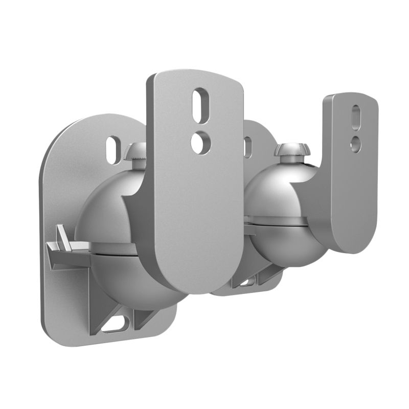

Something like this, most simple I can find, it supports up to 3.5kg (the SVS satelites are 2.9kg), can be angled downwards 20 degrees and left/right up to 180.
I guess that is the best solution. I will send a picture once it's up and running
Haven't seen that particular mount before...gotta link?
I've used the grip the ball style mount before altho a bit different....and often suffered from not gripping that ball very tight even with speakers less than the rated weight and would sag etc. Wonder how these are....
