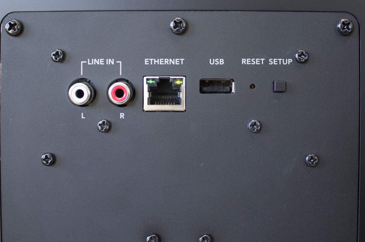

Thanks for your effort in helping me out. I really appreciate it. Yeah, as I mentioned, quality info on the full capabilities of these speakers is hard to come by. The One M I'm not worried about. That's for another room. Attached are photos of the inputs on the TV and the Stereo M speaker. Thanks again lovinthehd!

You're quite welcome. You just need to match gear up for use. Seems these speakers are more intended for music-only type applications, steered by digital devices. I can't make out the tv's panel in your photo, but does appear to be different from what I looked up for your model (what are the two rca jacks at the far right, the ones to the left look to be rca component video inputs) ?
Well it is complicated. That One M unit has an analog input via what that call a cinch connector. I have no idea what they mean. Can you post a picture of it.

Now you have posted a photograph, your best bet, is to get an optical to analog converter and connect the output to the two RCA audio inputs on the active speaker.
