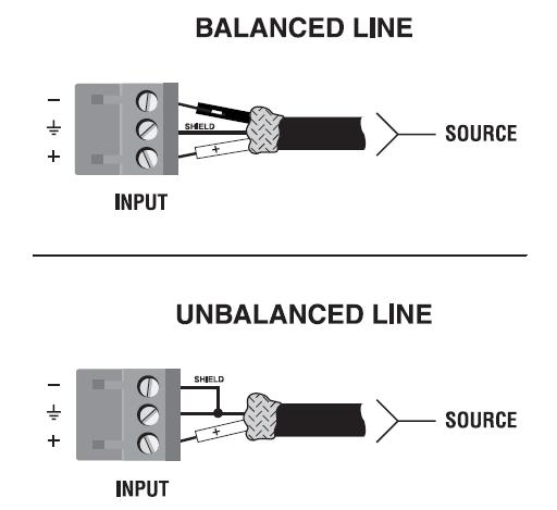

Unfortunately none of the above is correct. You have to construct what is called a floating line.
You can either connect three and one to ground at the RCA or the XLR. Two connects to the hot pin of the RCA.
Here is a good illustration.

How is "The closest it can come is "quasi-balanced", by using a twisted pair to carry the audio and a shield that's grounded on one end." different from your comment that "You can either connect three and one to ground at the RCA or the XLR. Two connects to the hot pin of the RCA."? It's still not balanced. Pin 1 is XLR ground, Pin 2 is Signal, non-inverted and Pin 3 is Signal, inverted. Just connecting a balanced audio feed to an RCA jack is NOT the best way to do this- using an impedance matching device that addresses the three to two conductors, is.
You can't balance the connection, unless both ends are balanced. The only way to balance it is with a transformer. Otherwise you have to float. I have done this frequently over the years and I know how you have to do this.
I don't know how his connector is connected internally, but if the OP uses a meter he can find out.
If it is connected as per the diagram in my link, it should not hum when he plugs it into the amp.
If it is connected correctly but still hums, he will have to balance with a transformer at his LFE out. That should not be necessary.

As mentioned in several posts here's an example of balanced and unbalanced connections.

As stated before, floating the line as per the diagrams should be satisfactory.
