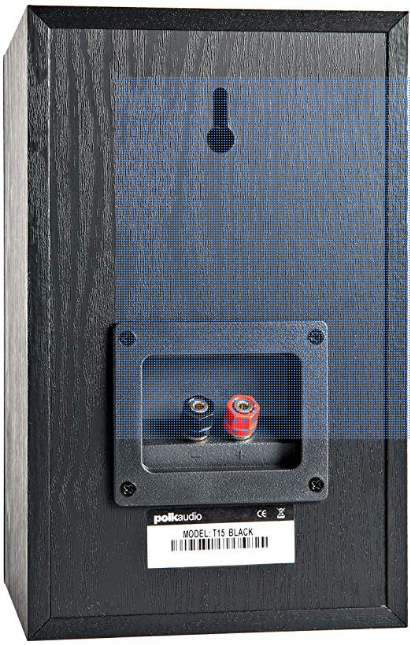

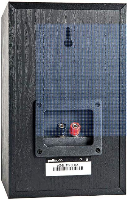

The T15 only has a keyhole mount so if you don't want to drill into the speakers you might look at something like this (there's more than one brand offering these, the ones I have like this are Pinpoint brand). For the center I'd build a small shelf perhaps....

That adjustable wall bracket is probably overkill for the small T15. The bracket supports up to 55 lbs. and the T15 may weigh as little as 8¼ lbs according to Amazon. I was surprised to find out that Polk provides no info at all on how much the T15 or T30 weigh.
If 8¼ lbs. is correct, a single screw with it's head inserted in the keyhole slot on the T15's back should work.
