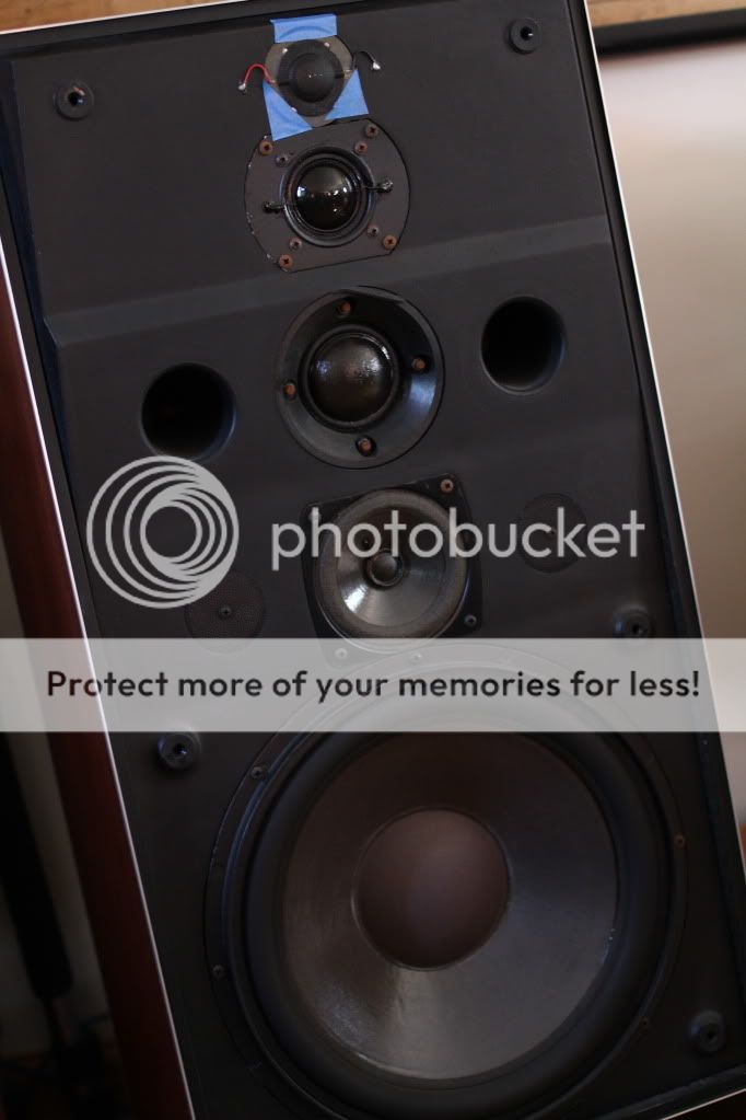

Howdy all. I recently inherited a pair of Beovox M100s from an uncle of mine who purchased them in ~1980 or so. At the time, they were the company's flagship model of floorstanding speakers. Specs are at the end of post, after pics. Some questions/concerns I'd like to pose to the experts here / those who are familiar with the model:
1. Can anyone tell me what these cones are made of, and if they appear to be in good condition? The large driver appears to be a paper cone, no? Some of the glue has deteriorated, and I'm holding a few pieces together with some painter's tape. Not sure if it's worth re-glueing.
2. What's an average lifespan for speakers of this type? (I know this is something of an unanswerable question as it depends upon many variables, e.g. construction quality, materials, usage, etc., but I'm looking for a very rough estimate as I know very little about speaker construction and durability -- what tends to die first on a given speaker, and in what time frame?) They spent ~25 years of their life in the same room, not moved often, and were used for 95% classical music. I believe the receiver was an old high-end NAD.
3. Are there any tests I can conduct to determine % functionality, or if a driver is shot? I wouldn't mind ordering some device or other to conduct testing. Complete noob in this area, but very eager to learn.

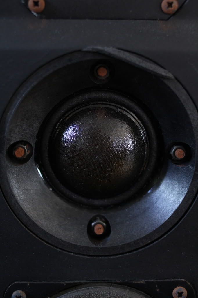

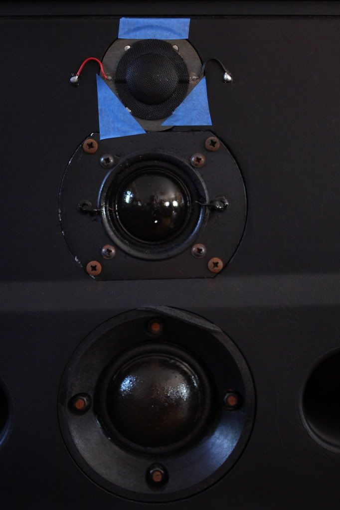

Stylish blue tape holding one of the grilles on the tweeter. Notice the rusting of the screws:
Midrange:
More rust, + something's un-tucked...?

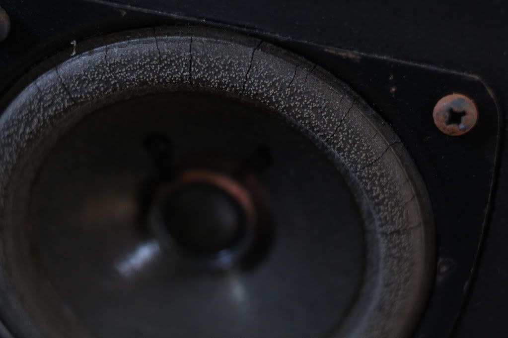

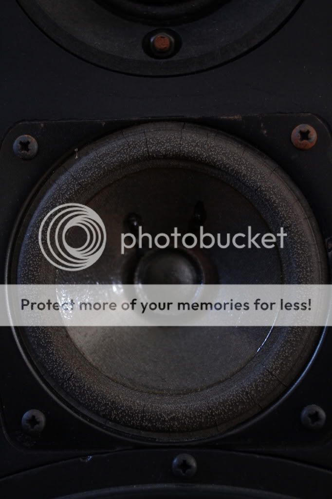

What's the edge of this cone made of? Something rubber, as it appears to be cracking?
Bass driver:

Those are old Peerless drivers. The bass cone is paper, the mid doped paper, and the rubber surround has deteriorated beyond hope.
The lower dome mid is fabric, the lower tweeter is melinex and the top tweeter I think is fabric.
Despite the hype on the Beo sited, these speakers were pretty dreadful.
You won't find parts and I would not put money and effort into them.
