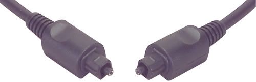

Here's what the end of an optical cable (also called TOSLINK) looks like:

The only problem I've had is connecting the optical port on the TV to the optical port on the DVD player. I've never used this sort of cable before, and I wasn't sure how to use it. One end fit easily into the TV. But the other is a mystery to me. There's a plug covering the DVD player's optical port. I assume I'm supposed to pull it out? I did, but I can't fit the other end of the optical cable in that port. Also, whereas one end of the cable looks clear, like a light bulb, the other end is sorta smudged with black. Other than that, the two ends of the optical cable look similar; not sure if they're supposed to be identical.
The optical connection is not a big deal for now because I have only the TV's built-in stereo speakers. For now, I just ran audio RCA cables from the DVD player to the stereo inputs on the TV. But it will be a bigger deal once I want to hook up the DVD player to an AV receiver for surround sound. Is there more than one type of optical cable? Did I do something wrong?

Regarding the optical cable, both ends should appear to be clear. If one is black or smudged, I suspect that you either have a defective cable or that there is a cap covering the termination. Both ends of the cable should look identical.
If you look, you can see how both ends have a small clear part on the end. This should be the case with any optical cable (at least those for home audio components).

The Optical connection on the TV is an output not an input so it won't work for the DVD player anyway.
