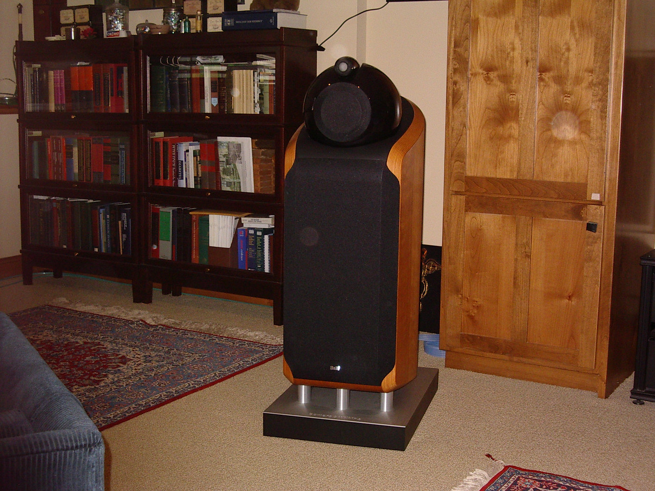

My friend and former colleague in arms so to speak had been becoming increasingly dissatisfied with his B & W 800 Ds.
Around the Christmas period I was demonstrating my new Intel NUC i5. Phil has always liked the speakers here at Eagan since I built them in 1989. Our Dermatologist at the clinic and an audio enthusiast was particularly keen on these speakers. I built them as my location monitors, which is why they are on wheels.
Anyhow Phil seemed to be paying more attention to the speakers than the NUC and frequently complimenting the sound of the speakers.

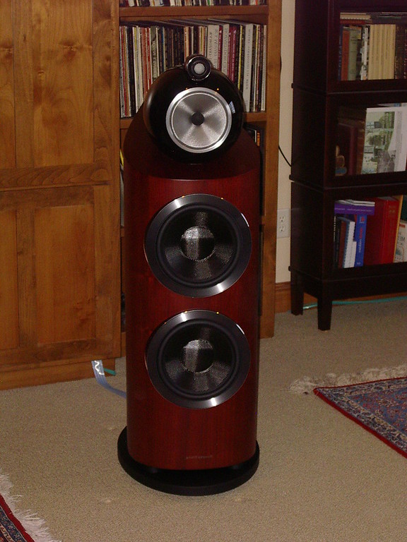

Right after Christmas he placed an order for a pair B & W 800 D3s, without audition. Remember these are $30,000 per pair. The dealer allowed him $9000 for the 800 Ds and his B & W sub.
The speakers were shipped from the UK and arrived in Minneapolis at the end of last week and were delivered today.
The major problem with the 200 Ds was that there was a little sibilance to speech, the violins were not as smooth as they should be and the sound stage lacked depth.
In addition the bass was a shade plumy with noticeable port kick in. The speakers did benifit from a sub but integration was always problematic.

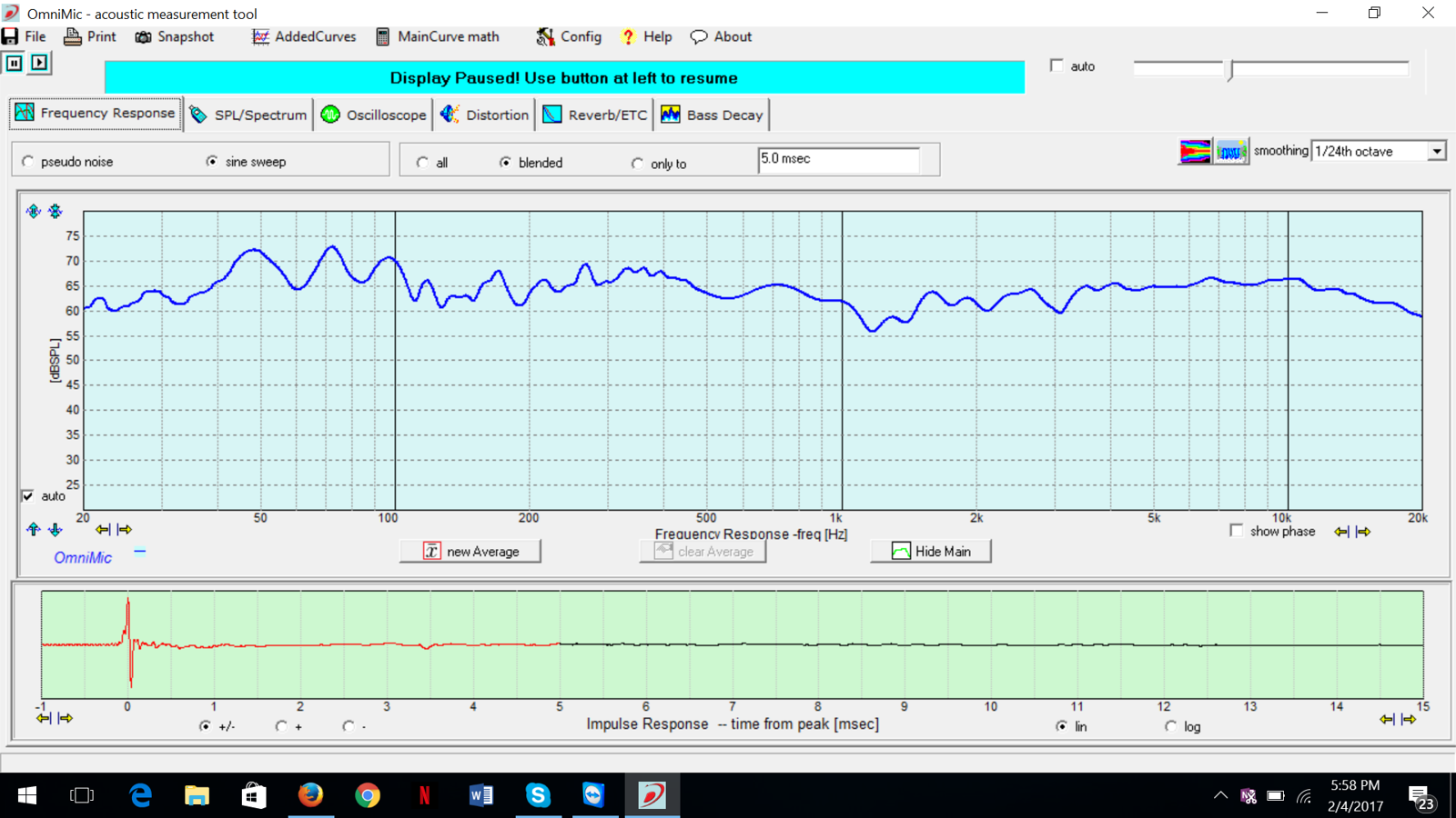

Last night I did a quick capture of the on axis frequency response and the impulse response of the B & W 800 Ds
Now this shows how little it takes to muck up a speaker. That hump from the kevlar cone break up mode between 3 KHz and 4.5 KHz is all it takes to upset the apple cart so to speak. The warmth is caused by the broad peak from 60 to 150 Hz. Port kick in can be seen below 30 Hz.
Immediate listening tests of the 800 D3 speakers were very encouraging. First up was Haydn's Mass in Time of War from this years Prom with Kings College and the Orchestra of the Age of Enlightenment under Stephen Cleobury.
Right away the bass was tight and perfectly balanced without bloom. The tymps which feature prominently were sharp and crisp. There was no overhang or boom. The strings and voices were smooth and the sound stage spectacular. The sound stage was wide and deep with much os the RAH acoustic preserved.

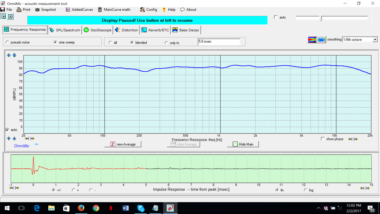

After that listening session I obtained this result under identical conditions to the test on the 800 Ds
The real problem area at 3 to 4 KHz is gone. There is a very slight rise from 60 to 100 Hz, but this may well be an artifact, and in any case if real would be inaudible.
The bass extends to 20 Hz and so this is a true full range speaker. The port cut in is far less pronounced.
The impulse response is improved as is usually the case as things improve.
Extended listening test today confirm that this is a first class speaker. It has quite the tightest bass of any porter speaker I have heard.
Listening tests with large choral works and big powerful organs confirmed that no sub is required for these speakers and in fact would be a detriment.
The sound is incredibly similar to the sound of my reference speakers. I would say that mine have perhaps marginally more visceral impact, but it is hard to be certain as they are in different rooms.
These speakers being passive, there is no way to electronically blend in the LFE channel. My speakers being triamped the LFE can be correctly mixed and blended in.
In summary I have to say that these 800 D3 speakers are worthy to be the flagship of the new B & W range. These are first class speakers, and ones that I am certain I could live with for year after year. I could not say the same about its predecessors.

One little issue, Mark..
800D measurement is nice 50db scale, while D3 is graph scale is 100db....

Well that is what happens when there is a ton of people in the room and it is two different days. Sorry about that, but you can still see the improvement, especially in the 3 to 4K Hz area. That was the major problem by far.

A couple of comments about the measurements (in addition to the scale issue), which I assume were done with the Dayton OmniMic. First, it looks like you've gone with the default smoothing function (1/6 Octave), which obscures a lot of information. 1/24 would be more informative, particularly in seeing the full contours of the 4-5 kHz peak in the Ds. Second, it appears that your omnimic software, like every other sample I've used or seen used, suffers from a inaccurate roll-off above 10 kHz. I'm not sure what causes this problem, but I would bet my government pension that the B&W's are actually flat between 10k and 20k, or even rising.

I think the mic must roll off. Every speaker I have tested with that rig rolls off at the top end like that, soI agree it is a feature of the program.

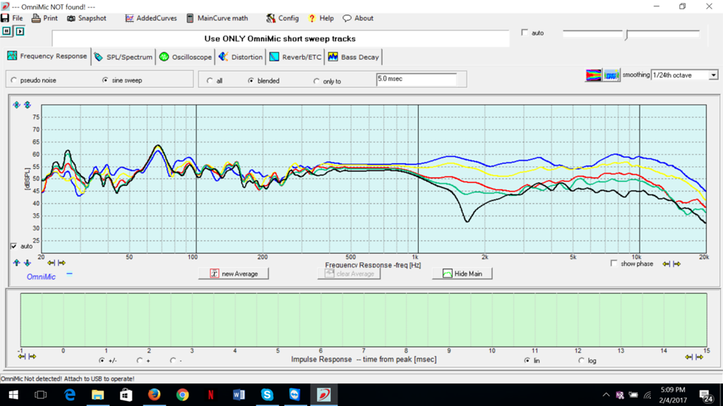

Dennis, I returned today, and got date with some peace and quiet, and did more listening tests.
The B & W 800 D is a very nice speaker. It is not forward like the older versions. The sound stage is nice and recessed.
Here is the FR on and off axis. I went all the way to 90 degrees, which is not a total disaster.
Axis Blue
15 degrees off axis Yellow
45 degrees off axis Red
60 degrees off axis Green
90 degrees off axis Black
All measurements 1 meter on tweeter axis.
I don't really care about the roll off real or not. The extreme high end has little to do with how a good speaker really sounds, unless the high end rises.
These speakers are just a fraction retiring which I like. The older versions of the 800 series I think were aimed to please the pop enthusiast. To me these speakers seem squarely voiced at the classical music listener, which is as it should be, as that is really the bread and butter of the high end speaker market. It really is of no consequence what rock and pop sound like, since no one knows what it is supposed to sound like in the first place!
I think the really good off axis response is why these speakers have such a good sound stage.

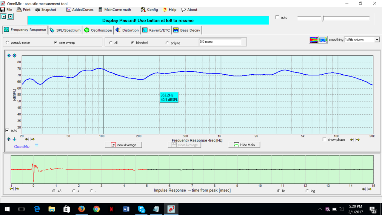

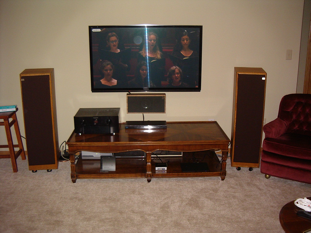

I did take a quick snap shot if my Eagan speakers which were the immediate precipitation to Phil forking out 30K on new speakers. I have never bothered to measure these speakers. They were built in 1989. I used Bullock and White's software on an Apple IIe, for enclosures and crossovers. I did the critical voicing entirely by ear as so many did back then.
It is an unusual design. It is basically a 3.5 way. Tweeter is Scanspeak with two Dynaudio large VC drivers. The crossover is 3 KHz to the tweeter. The two Dynaudios each have their own sealed enclosure, so one can not drive the other. F3 is 90 Hz, with electronic crossover at 90 Hz second order for composite fourth order. The lower driver provides BSC. The low end is two Morel 9" subwoofer drivers, in coupled cavity isobarik configuration. Calculated f3 points are 90 Hz and 27 Hz. With this bandwidth the Q of the bass system is 0.7. The sub drivers are driven to 120 Hz so the high end roll off of the bass system is essentially acoustic.
The whole purpose of the design was to provide for location monitors for my radio broadcasts and recordings, that was not massive and had a very respectable low end response.
Musicians really used to like these speakers on session playback. My wife loves these speakers, but not the size!
The on axis response is pretty good, although not really top notch. I can see why you think they're a little retiring. That's a matter of taste, I guess, but I would still prefer to hear a recording exactly the way it left the studio. As for the top octave, the problem with the OmiMic is that the response may very well be rising. Virtually every speaker I've measured with OmniMic droops in the top octave, including some that are actually voiced quite hot in that region. Of course, all of this will be more of an issue to younger listeners than fossils like me.
