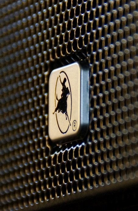

I have to ask: What kind of mesh (round or hex... photos weren't clear)? Can we approximate open area? And why does it work here? And if it can work here, why not elsewhere?
Please and thank you! :cool:
They use round holes. Here is a close up:
The Outlaw grilles do cause some comb-filtering effects, which is more prevalent above 16 kHz which would not be very audible to most people. The nature of their effects look more apparent on a simple response graph then they would be heard. The reason is that a microphone only measures the response at a single location in space, but the nature of the comb-filtering would change the response according to distance and frequency. If I measured the response at a whole bunch of different distances and averaged them out, the end response on such a graph would effectively resemble the response without grille. In other words the grille doesn't interfere with the response all that much.
