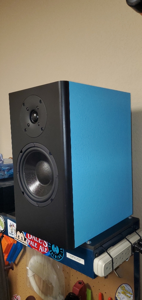

So, when you do a black baffle and painted or veneered box, do you paint the baffle and then mount it, or do you assemble the box and mask off the baffle? I would think that it's hard to get a seamless transition unless you wet sand flat and then lacquer over top?
In this case, I painted the baffle, glued it on (XO already installed), then did the blue finish. I used very good quality Frog brand masking tape and was very happy with the transition from one to the other. In fact, the very reason I went with a different color on the baffle is that I found that the Duratex material does not hide seams as well as I thought it would (found that out on my MK BOOM build that I had mentioned). Thus, I decided to avoid that problem (i.e. more sanding) completely by making the seams a completely different finish material and texture (it is tough to see the relief texture of the blue duratex in the pic).
BUT.....be aware that by painting first, I had to come back and re-sand and refinish the spots where my clamps were for the baffle gluing. In the future, I would likely go ahead and install the XOs, glue it all up, mask it off, then work on the finish as a whole. That's the "nice" thing about DIY, you always learn from your previous work and know better for your next project.

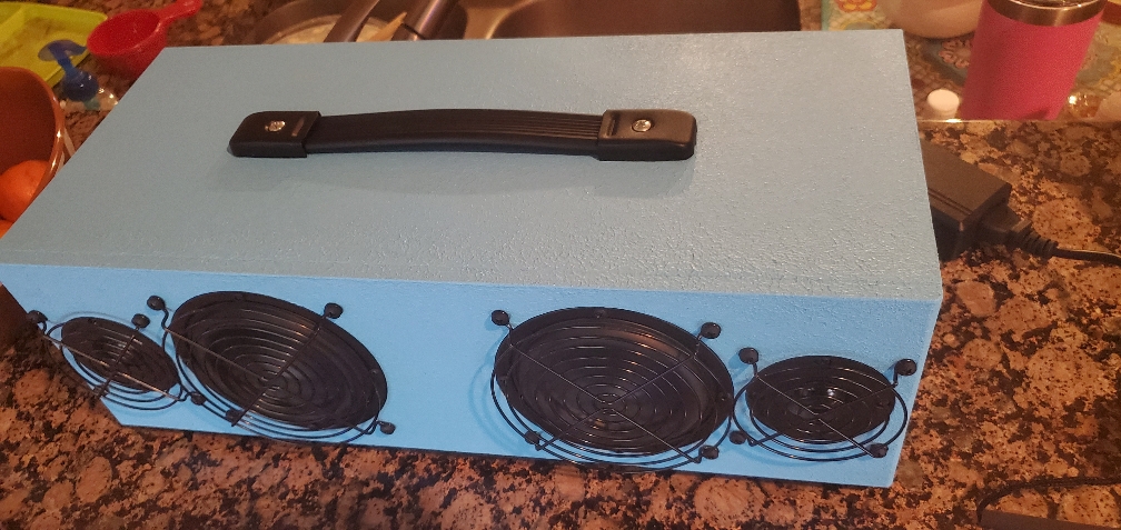

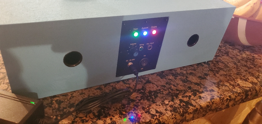

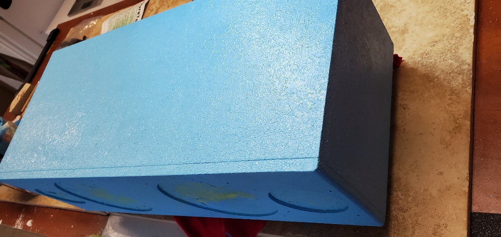

Here is my PE MK Boom build. You can see what I'm talking about on the seams and also see the texture better in this pic. I am very pleased with how this turned out! Seams is nitpicking, but if I had realized, I would have sanded those better before applying the duratex.

@MrBoat here you go! The baffle is primered with killz, sanded at 220, rattle can flat black. Every other part of the cab is Duratex (bought it white and tinted to sky blue, leftover from a build of the PE MK Boom portable BT speaker build). I like to make a kind of "faux leather" texture with the duratex.
These are currently my garage speakers, where they are in use daily.
Pretty easy to see that my skill, experience, and patience for the finishing work is not at your level. But, I do think I get pretty good results within my skill set and for likely much less time investment than you. And, of course I get a little better at it with each build, learn from previous mistakes and difficulties.
But, my electronics skill and experience is top notch.
