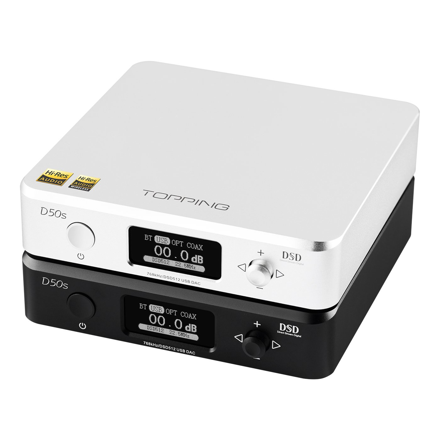

Sure, but which shade?;)
Funny!
The one in my cart is black.
Listen, I have so so so much gear... That I want to enjoy the process of buying every single gadget endlessly or I will end up being kicked out by all the girls I live with.
Now seriously, I have almost discarded the Bluesound Node in favour of a Chromecast streamer and a dac. Lots to learn and little time.
Anyway, learning and having fun. Any help will be great.

For this last setup I have a pair of Wharfedale Evo 4.2 paired with an XTZ EDGE A2-300 and I just bought a Topping D50S that should arrive in a few days. For now I will be using an Android phone as a streamer and the Tidal app (Or any app that can stream to Chromecast), but this may change.
