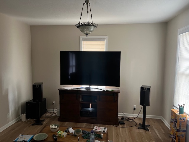

I’ve been considering the ascends along with maybe the ribbon upgrade but others are saying the bMR’s are more neutral to their environment. I also have glass French doors at my first reflection point. Oh happy days… did I mention the hardwood floors, lol.

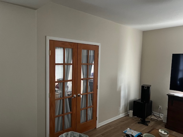

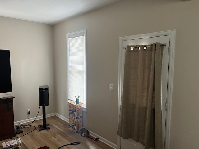

tanktop, do not take this the wrong way, but looking at those pics your room is an acoustic nightmare. You mentioned a few of the issues, address them first and then concentrate on speakers

No offense taken and that’s the advice I would give someone else. Definitely will be doing some room treatment with current system before upgrading equipment. I personally believe lower end decent equipment can sound great if the basics of placement and room accustics are addressed. Thanks for your input!

In response to the’small peak’ I was being kind to the speaker. If you look at the 2nd photo there’s a PB1000 behind the speaker so you can use that as a reference point for how far the speakers are from the rear and side walls. They are also significantly towed in pointing about a foot behind my head, helps with the small peak.. lol.

I don't think you room is that bad. Sure it has windows that will create a first reflection and so do I. It seem to have a dominant dimension along the long axis which is excellent.
