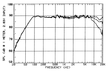

Check out the frequency response of these

Not better in price than pretty much anything... but while we're looking at charts from there... how about this one:
YG Acoustics Anat Reference Main Module:
Sure they cost half what my house did... but I bet they sound halfway decent. ;)
@josten - thanks for that. That chart puts many things into perspective. I realized that the resolution was siginificantly reduced on the Ascend graphs, but I didn't realize to what extent. Sad - but still think I'm going with them (or do some more research still). :D
3db
3db
You got that right... and I've actually heard them and they don't sound bad at all - of course, that's without being able to do a blind shootout with anything else.
If you did like the sound, I'm wondering if there is more to a speakers sound than one the test graphs depict? Is it possible to have poor measurements and still come out sounding good? I realize I'm implying audiophilia but it does have me thhinking. :confused:
Of particular humor (at least I thought so) was "Chart 4 - Deviation from Linearity at 90dB and Above". At first this confused the crap out of me since it seemed to be indicating perfect linearity, which clearly was not being indicated in the FR plots... then the light came on. These charts simply state that the exact same crappy FR is present whether the speakers are playing at 70db or 90db - or at least I think that's what they're saying.
That's pretty hillarious, because most halfway decent drivers should have extremely similar FR within that range - now maybe if pushed over 110db you'd have something else entirely... but for the cost, I'd be utterly stupified if they couldn't reach referrence levels while maintaining their composure. :) .
I think it describes the behaviour of the speaker at two different volume levels. They should be linear but I've seen some gaphs where the linearity was noticeablly different between the 2 volume levels.

I know we started this thread with one expensive bookshelfs which I still don't consider to have flat response, however I did found few graphs I liked much more:
Almost all PSB's:
http://www.soundstagenetwork.com/measurements/speakers/psb_image_t45/
At just 45-degrees off-axis you've got a 10db spread (more) by 10khz. I'm not in love with that.
I didn't look at all the charts, but there were others that looked far better in there (the Paradigms IIRC)
