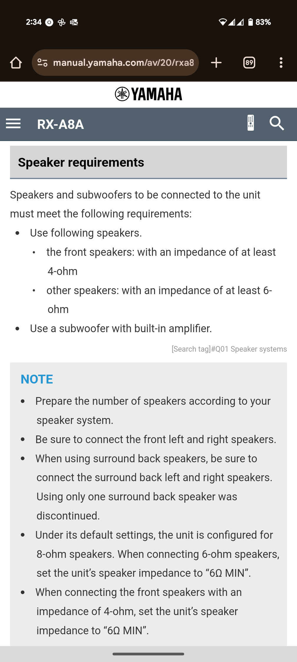

Here's the exact wording, it mentions connecting the 2 front speakers and then the other speakers...
Have a read of the following thread by Gene explaining the reason why some manufacturers suggest impedance switching. Gene is an electrical engineer and a reliable source on this:
Antares
Antares
If it can drive two 4 ohm speakers I don't see why it would not be able to drive just the one.
