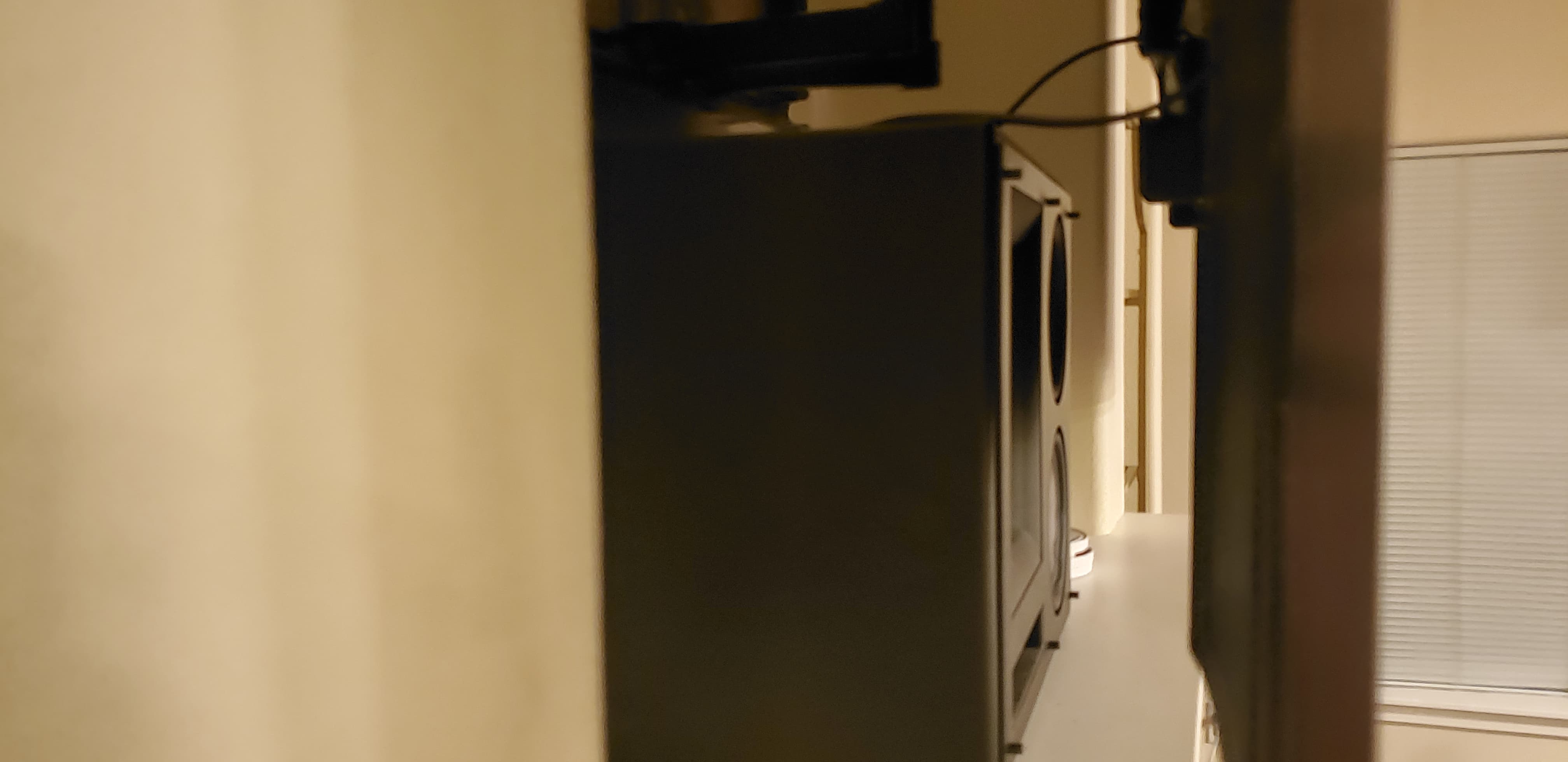

I'm almost embarrassed to ask this question and show my center channel placement but I don't have much choice. I live in a town house and it came with this weird built in entertainment center that has a fireplace in the middle of it and shelf that's above the fireplace that's been recessed into wall for your TV to go on, but the problem is the opening that is meant for your TV to go in is only 50in wide (clearly this was designed by a woman :rolleyes:). since I have a 60in LCD Samsung I had to mount it to the wall on a arm and bring the TV out passed the opening this worked fine even if it does look a little strange. This left a huge area behind my TV that I placed my center channel on the problem is that I have the Klipsch THX Ultra2 Surround system and the LCR's are the same speaker so the center channel is very tall and boxy for a center speaker, and half of the TV blocks it. this gives me a pretty bad echo and makes the speaker sound more like a horn (imagine that). I can't move the TV up anymore because it will be on the ceiling at that point and its already to high up on the wall for me as it is, thinking about putting acoustic foam on the back of the TV and the cavity that the speaker is sitting in hoping that will help what do you guys think what would you do?

I would move the tv down closer to the mantle leaving more space up top. Buy a wall mount for the center speaker with longer arms and angle the speaker down toward the listening position. Padding behind the tv will not help that situation.
If that doesn’t work maybe a mount from the ceiling. You have to get the speaker away from obstructions.

Why not make a bracket with an extendable arm you can mount a appropriate sized shelf to the. place the centre on so you can get it in front of your display.
Mount the bracket inside the shelf wall your display sits in and Bobby’s your uncle:p
It’s not a hard fix grasshopper just an hr of your time. It will look badass once done and be something to show off your innovative HT skills!

Yeah, I'm going to tell you what to do. Relocate the system to a room/wall/space which accommodates the system, instead of attempting to come into compliance with someone else's notion of how it's supposed to be. It's ugly, it looks ill-conceived, and it does not support the LCR configuration. Now, if you are precluded to the space, then buy a smaller TV and get a proper center channel for the scenario. That's it. Life is too short to let this installation take more than a few minutes of your time. One more thing, the TV is too high, you would need to view it from a bar stool to not get a sore neck from typical viewing. It shows that interior design must be compatible with actual life style. In your case likely wanting comfortable viewing from a couch without having to look up.

How come we can see so much of the centre speaker from the point of view picture but when scrolling to the shot showing the centre behind the tv it looks totally blocked?

It looks like for the front pics the camera angle is from under the tv. Intentionally, it appears. Maybe because it doesn't look so bad from that angle... lol.

Tough call. None of us would like this anymore then wseroyer. If your dead set on utilizing your centre your going to need to make a mount with a shelf below your tv and relocate that centre in front and below your tv.
Your Eucherd with that fireplace so a compromise is definitely in order. The choice comes down to the Phantom centre or build a shelf mounted off the fireplace to relocate the centre.
Phantom centre is obviously a no brainer, the shelf requires a bit more time and planning.
Try watching your shows for a week without your centre connected using your main phantom centre and see if your satisfied. Just like an audition. If it doesn’t work out at least your not dwelling on it and you can build your centre a mount with a shelf!
