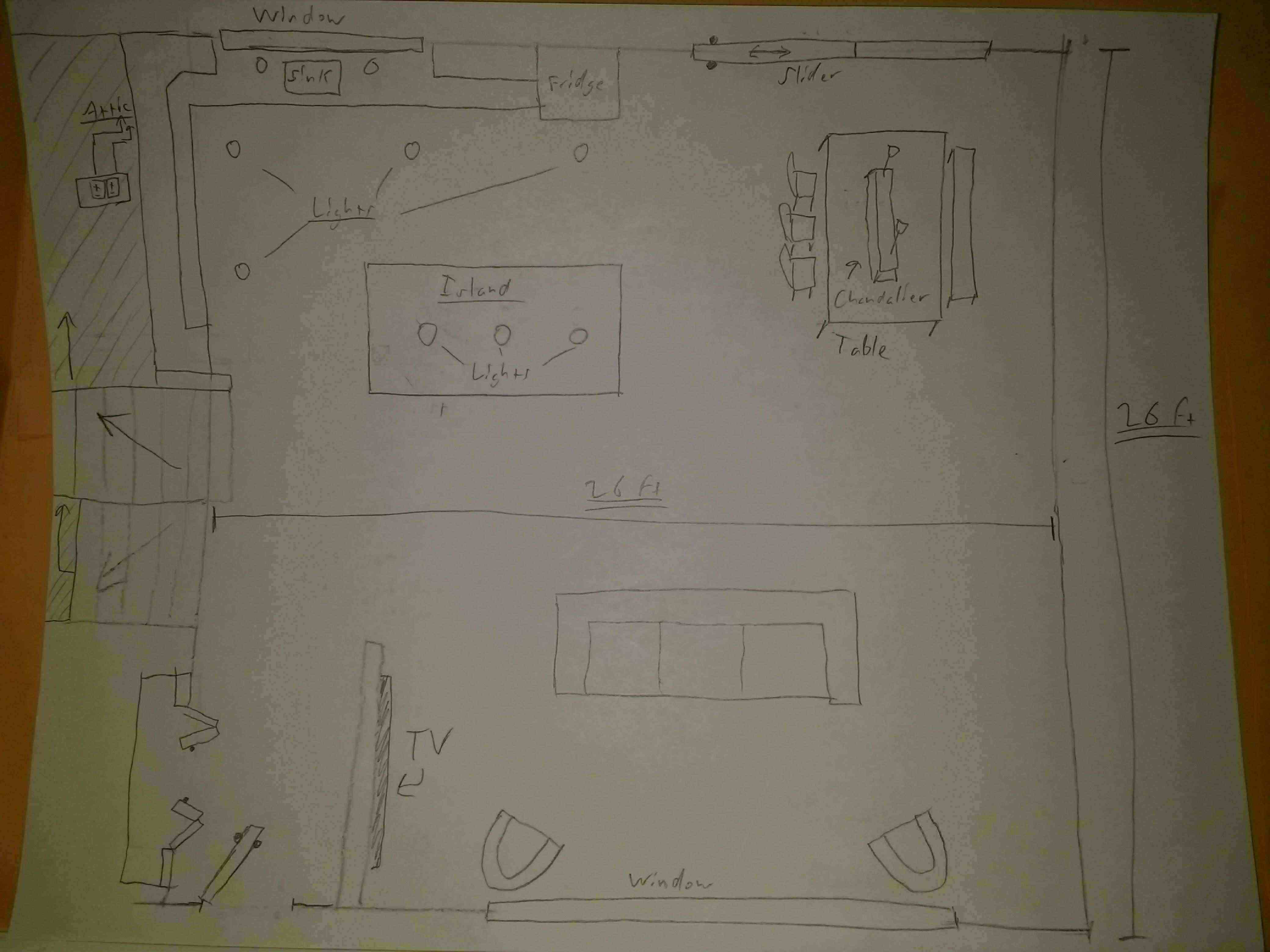

Thanks for the advice. I've included a rough drawing of the room (sorry for poor image quality, had to compress it). I'm not too concerned about kitchen noise, but I would like to be able to hear the music clearly in the kitchen as much as the rest of the room.

Michael View attachment 27082
If mono, I would go with 3 or 4 8"...if stereo...four 8". (Mono in this environment is not bad, even preferred in some circles). I probably would not use 6.5" especially if the ceiling is higher than 8'.
I put a pair of 8" inceiling speakers in my greatroom and my sunroom...really for whole-house music, but our houseplan is open much like yours and it's an ideal entertaining space. So rethought my intentions and ramped up the quality of the speakers in case we wanted some festive type atmosphere. We recently had 2 dinner parties, and to steal your very appropriate phrase, "after a whiskey or two", the music playlist became much a bigger part of the evening than I anticipated.....I'm glad I did ramp up those speakers.
But...if you're pretty sure that back ground music turned up every once in a while will suffice.
The Polks I use for Atmos will be fine. The RC80i are not as accurate or image as well as my Noble FidelityL85mkii, but they can get pretty loud...3 to 4 in that space should be plenty.
