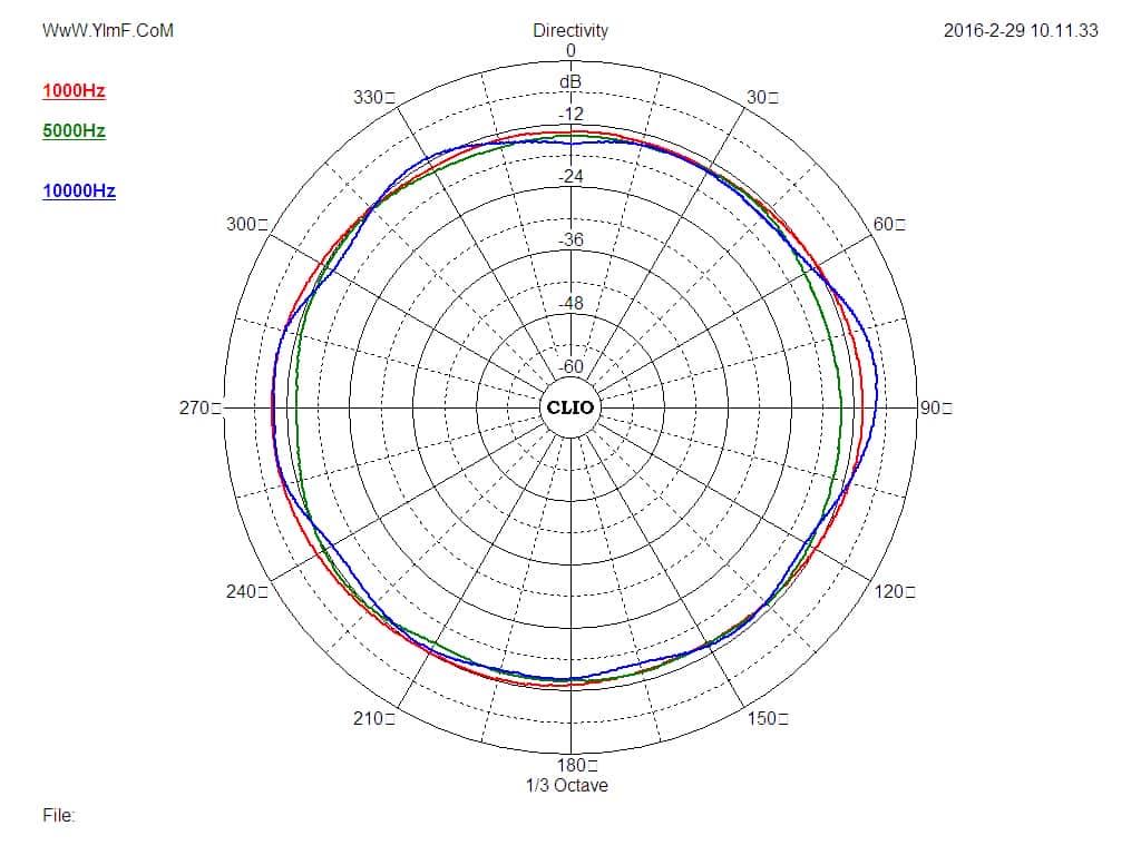

For a ceiling speaker, the ideal is NO tweeter.
Please explain in what Application and the Logic behind that
Because for Atmos speakers to work optimally you need a perfect circular dispersion pattern, with zero lobing. Only a good full ranger will do that.
I can tell you that those ceiling speakers of mine work to absolute perfection.
Once this pandemic is over I'm going to build some designs for those speakers. You can get deeper bass out of them than most towers. Their mid range is ruler smooth and as I said the HF is better than most tweeters. Quite soon I am going to put together a labyrinth design for them. At 45 watts each speaker, for a lot of rooms you would have quite enough power and the sound would be awesome. All speakers 8 ohms and zero phase angle problems. The best crossover is no crossover. That is perfect for AV as there will be no time disturbances and excellent voice intelligibility.
With a labyrinth you could get and Fs of 41 Hz and 12 db roll off, so only 15 db down around 20 Hz. Very few towers can match that.
OK so you mean no tweeters for Atmos applications only.
Not at all. The ideal speaker is actually a full ranger. Getting good full rangers has been neglected for far too long. From what we now know about time aberrations and speech discrimination, full rangers could have enormous benefit in the AV environment. Center speakers especially come to mind. In our Eagan Town Home bolt hole we had, I used a full range center for years and it was phenomenally successful and had very superior speech quality and intelligibility.

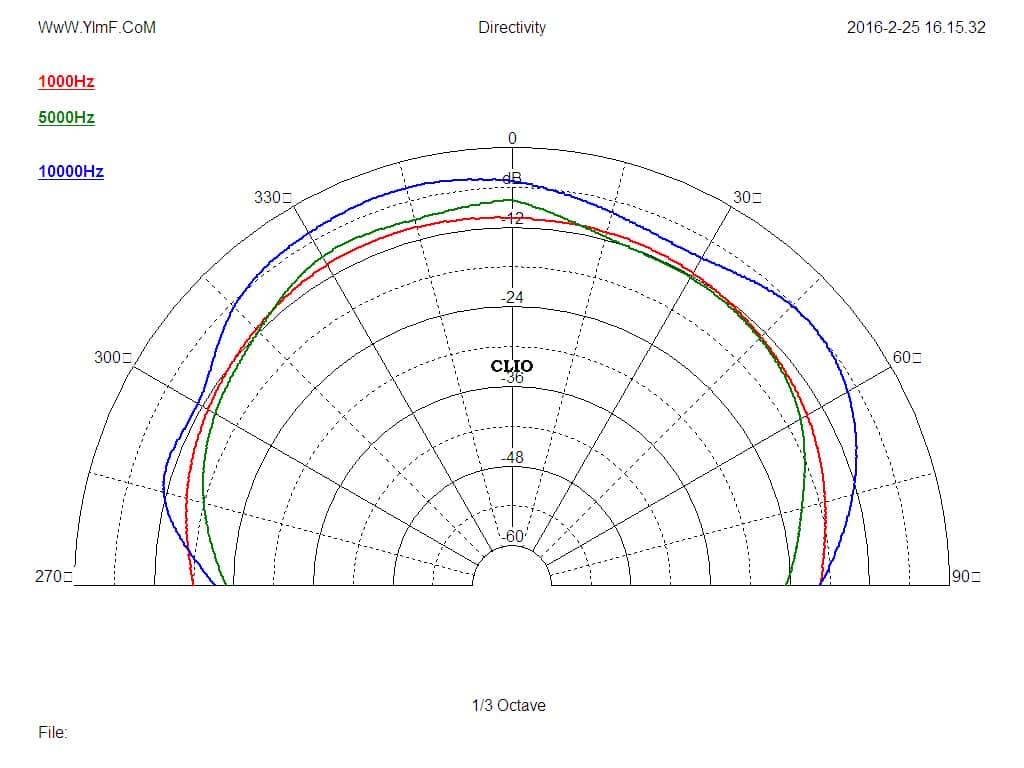

Well, it seems to have pretty good horizontal dispersion. However it needs a back enclosure as really every driver does. It is also expensive. I addition the filters are only first order 6db. With the cross at 2.5K HZ, the tweeter is only 6 db down at 1250 Hz, and only 12 db down at 625 Hz. So you wonder about tweeter stress.
I really do believe that 6 3/4" full ranger is the better bet. Making the small 0.25 cu.ft back box is duck soup. You just need to fill it with Polyfill which is cheap.
So I would venture to suggest that the full ranger as an Atmos speaker is the better of the two at significantly less cost. So if you are doing it now, that solution is my top pick.
