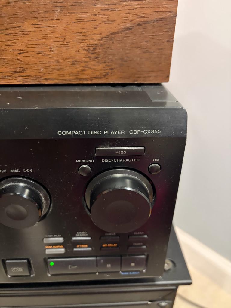

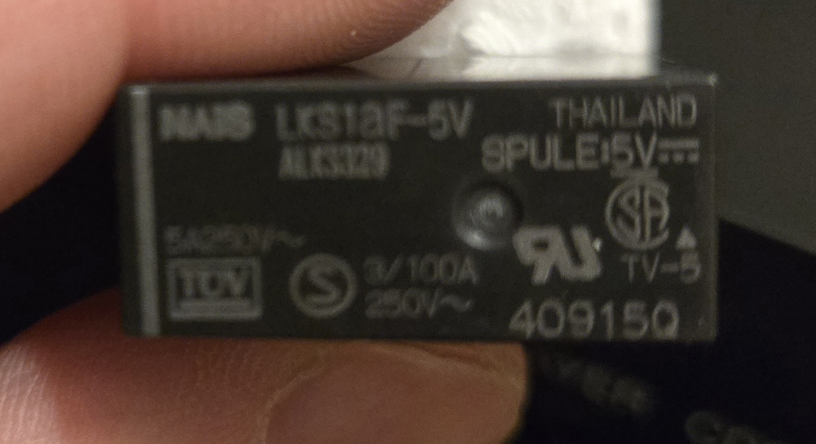

Hi there. This model is 30 ish years old. Sony CDP-CX355. I replaced the drive belts due to age and fired it back up and got a clicking noise out of the power relay. I replaced it cheaply. Same clicking. I don't wish to pay anyone. I thought I was so close! Let me know your ideas. The power won't come on.

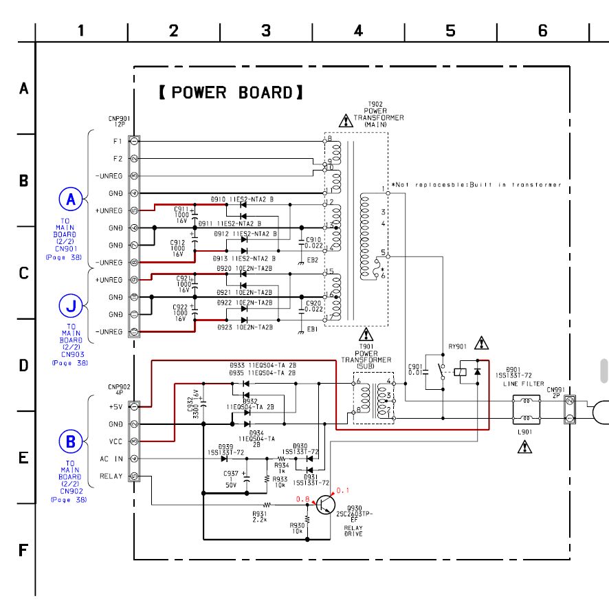

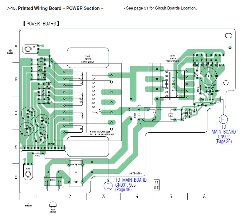

You will want the service manual to tackle this. Link is below for electrotanya. The power supply board and circuit diagram are on page 44. The lower potion of the schematic is the relay circuit. I would start by checking Q930, the diodes and capacitors on that circuit board, but note that the circuit also connects to the main board so the repair may not be trivial if the problem is not isolated to the power board.

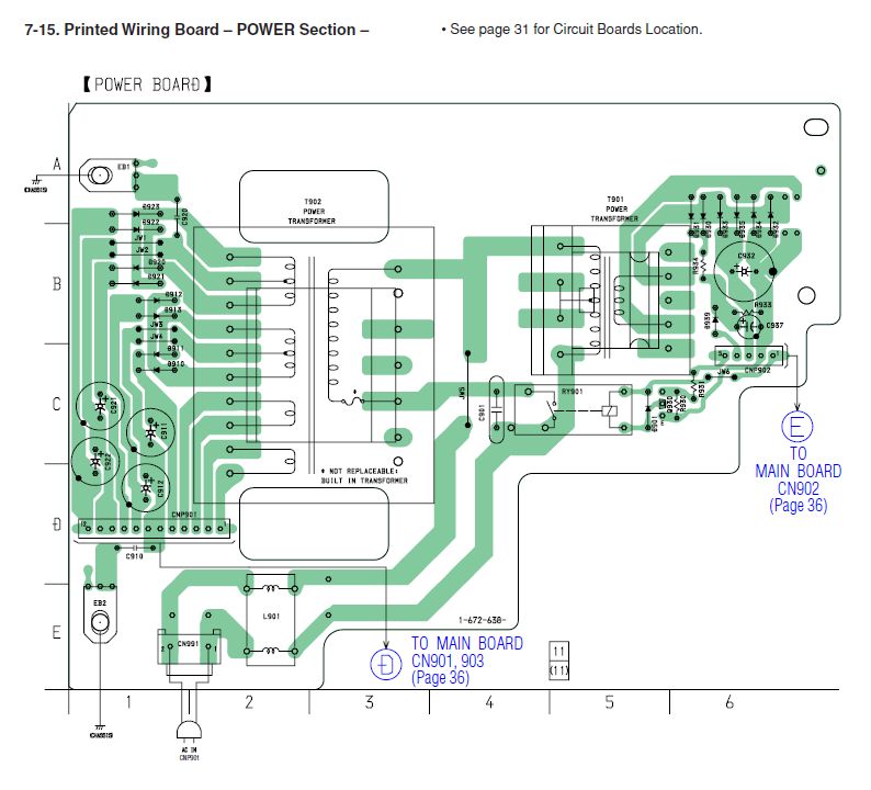

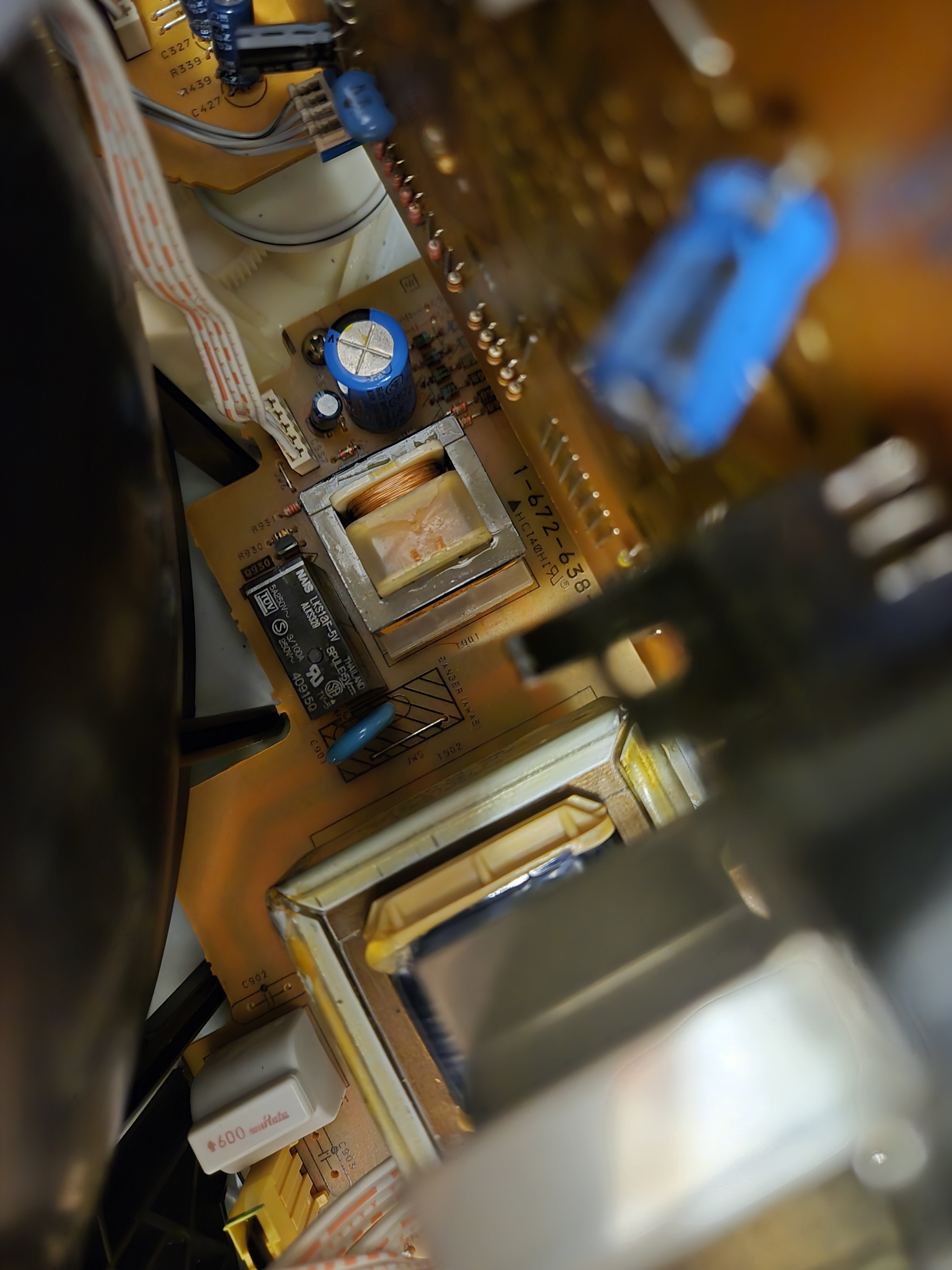

Here is the power board with the relay (the mains plug cut off on the right)

If the problem is on the power board, it may be repairable. The small transformer T901 feeds four diodes that form a bridge rectifier and supply unregulated voltage VCC. On CN902 VCC is supplying voltage to IC931 on the main board and should be 7.9V. I think IC930 and IC931 are both voltage regulators. IC931 supplies 5.1V to the main system control IC (pin 11 VDD) and also the 5V back to the relay (+5V pin 1 on CN902). The AC IN and RELAY connections come from the main system control IC (pins 18 and 19), so the main control IC turns on the relay.
I would look at the components that form the relay control circuit on the power board. The relay switches on power to the main transformer. If the problem is not on the power board but the main board then the issue will be beyond the skills of most repair techs. There is the odd chance that IC930 or IC931 are defective, but if the relay is clicking on and off constantly and the power board is fine, then there likely is an issue with the main system control IC or governing circuits, in which case the unit is beyond repair.

He can check those voltages easily, but should probably use a VOM amplified meter so as not to load the circuits. He will be lucky of the fault is on that board. I suspect the relay is clicking as something is trying to draw too much current from the power supply.
I agree the main board is unlikely to be serviceable.
Yes, hard to know at this point if the main control IC has current sensing and is shutting off the relay due to a power draw issue elsewhere in the circuit but that is likely the issue. This is one of those high capacity CD changers, so I would disconnect all of the motors in case the unit has some kind of mechanical startup procedure that it goes through on power up. Just leave the electronics connected and see if it will power on.
The unit has a lot of small circuit boards but there are only 3 or 4 larger circuit boards of consequence that could cause an issue. Could be an issue with the power supply itself but that is less likely. Need to isolate the main circuit boards and see if one is causing a large power draw.

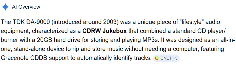

Teac (or was it TDK?) made an interesting machine for a while that although it held only one disc it would read it at a fast speed(?) and rip/record it to its internal hard drive (and I'm not certain but I think you could supplement that storage on your own for larger libraries?). So once you filled it up with CDs, it then performed similarly to a "Mega-changer" as Sony used to call those machines. [Better in fact, since there was no "disengage disc, rotate carousel to the next one, extract it, spin up and read the table of contents" delays when changing from a song on one disc to another.] It seemed like a good concept to me at the time for people not wanting to glue a computer to their audio rig and manually doing this sort of thing—a laborious process.
