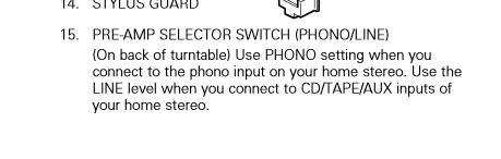

The other question I forgot to ask is...what are you using for your music source?
Honestly the only thing I use this for is with my Technica LP60 turntable
Thanks fellas for all the help, your are great!
I will try the phase thing after work but after changing some things and adding my 2 extra Micca book shelf speakers as surround, this thing is crazy loud! I mean considering what I have it is.
Should my "db" be set on the highest? It seems to make everything sound better, more powerful?

Is your switch position set to line out on the turntable since teh Yamaha does NOT have a phono stage as shown below from the owner's manual?
3db
3db
Yes set to Line, not phono
Good. Then do what PENG recommends. Reset the AVR and use Straight or Stereo mode. Do not use Pure Direct as I believe it disables the sub out. Also, ensure your left/right are set to small and set the crossover to 80 Hz. Set bass out to subwoofer only. That should get you squared away.
