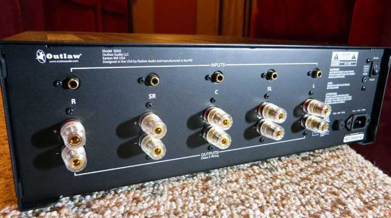

I have the manuals, however they just say RCA cable. My understanding was that this is merely the type of connection and not the type of line. I have a Budgie Hybrid phono preamp, Integra DTM 40.7 stereo receiver, a generic 90's Kenwood cd player (RCA only hookups) and an Outlaw 5000 power amp. Sub is a ML Dynamo 700 powered sub.

everything you have listed so far is analog (RCA)
