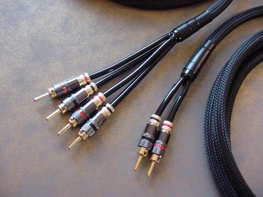

Looking for any suggestions on how to get speaker cable into cable pants. I have 12g axiom speaker cable and both 11mm and 14mm cable pants. The rubber against rubber just wont let the cable slide into the cable pants. Tried to use a little liquid soap on the cable but still no go.

I soaked mine in hot soapy water before sliding them on. The heat allowed them to expand enough to go on easier and the soapy water was the lube. I wouldn't use just soap since it never truly washes off. The hard part is getting the wire ends through each leg. I made the legs EXTRA long so they would slide though easier. Then after I got the pants on all the way I carefully rolled the leg of each side up and cut the wires to length. Since I used crimp-on bananas in some places, I cut the wires a little shorter than the pants legs so when the bananas were crimped on the pant leg would cover the crimp.
You can go REALLY crazy by adding flexible sleeves over the entire length of the cable, then the cable pants and then put a small length of heat shrink over the where the flexible sleeve is covered by the cable pants. That will make a cable EXACTLY like the one in your picture. The cable sleeve is available through Wirecare and comes in many colors, including chrome.

...You can go REALLY crazy by adding flexible sleeves over the entire length of the cable, then the cable pants and then put a small length of heat shrink over the where the flexible sleeve is covered by the cable pants. That will make a cable EXACTLY like the one in your picture...
Hey, you're absolutely right. I know, because I took that picture of my cables.:) Flattered to see it's getting some mileage.
