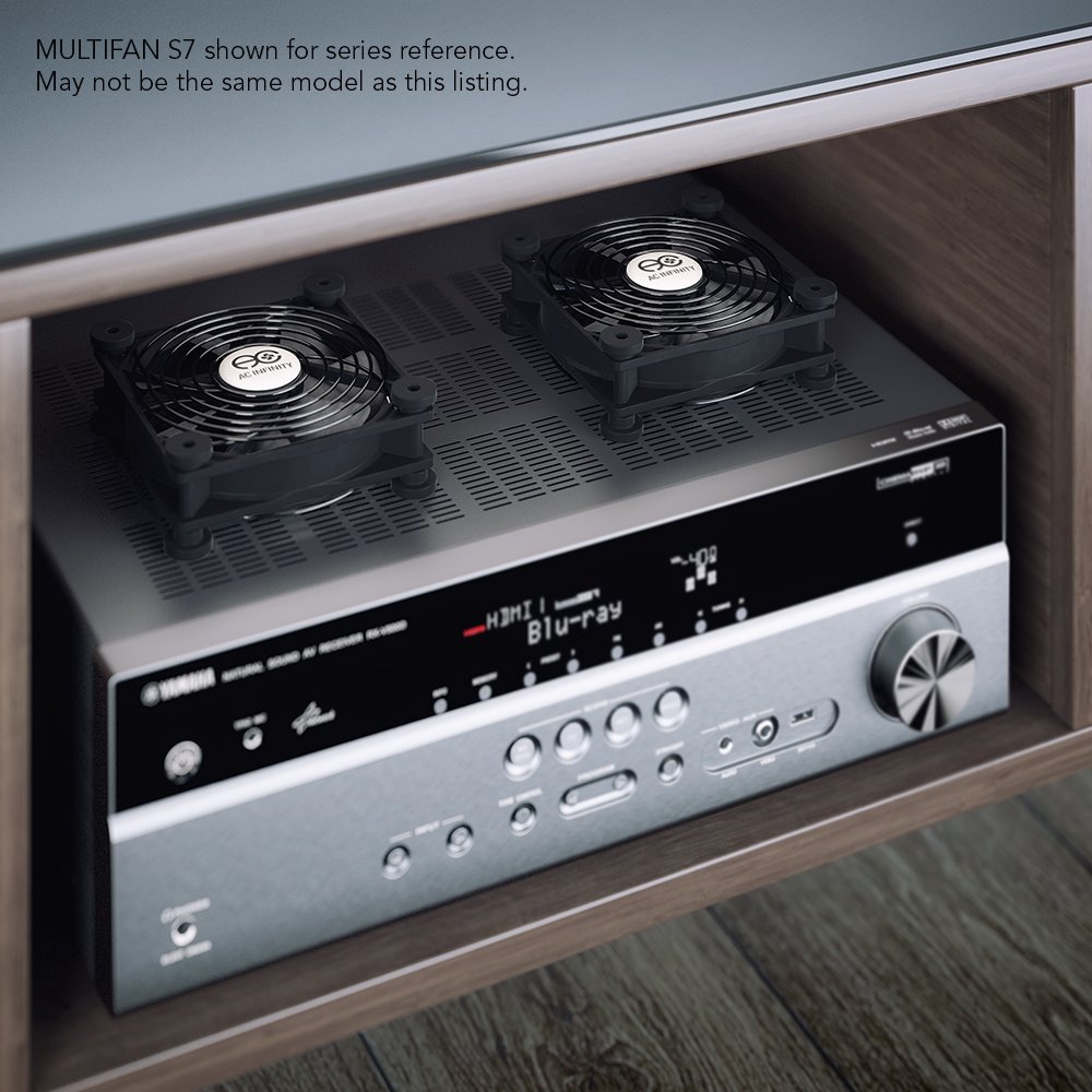

At $20, I consider this cheap insurance (I add ventilation to all of my amps/AVR's that see regular use). I just keep mine on the low setting and plug it into the back of the AVR so it turns on when the AVR does.:
https://www.amazon.com/gp/product/B00JLV4BWC/ref=oh_aui_search_detailpage?ie=UTF8&psc=1
These fans on low are not bad, but you will still hear them between songs if you room is good and quiet.

cool thats a good idea,and i have a ton of extra computer fans laying around from a couple builds i worked on so that shouldnt be a problem,i have a few 140mm fans that would work perfectly

a few people keep warning me about the overheating issues that onkyo had,did the integra also have that problem? or will the fans be enough to keep it cool? lastly would it still overheat even tho im not using any of the hdmi's?
My Onkyo from that area ran relatively warm, then last year had the hdmi/network board issue that Onkyo/Integra avrs were famous for, and after repair I swear it runs a bit cooler (but didn't put a thermometer on before/after to check). An external fan should do the trick, even in a somewhat confined space (but if you provide plenty of free air around it, it may not matter much). The hdmi board I'd guess is always on, you might minimize processing by not using the on-board video processing...
