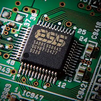

You can't just go by "burr brown 192/24..", you have to know the DAC's model number, download the datasheet and compare the specs.
As far as I can tell from the Yamaha website, the RN 303's DAC is the ES9006AS so I don't know why you say it has a Burr Brown DAC. Edit: Yamaha website does not say which DAC chip is used in the R-N303.
The Modi 3 supposedly has the AK4490
The AK4490 chip has much better THD specs than the E9006 but implementation also matter so it is hard to tell but as others mentioned, you won't likely be able to hear the difference.
Both DACs will sound the same whether they are Burr-Brown, Sabre (E9006 = THD 0.00079%, SNR 120dB), AK (AK4490 = THD 0.00025%, SNR 120dB), etc.
We can't even hear THD of 0.1% unless you have "golden ears".
So as you can see, nobody is going to hear a difference between THD of 0.00079% and SNR of 120dB vs THD of 0.00025%. :D
The one you've shown is the Yamaha 803. It has the sabre chip. I have the Yamaha RN 303.
PENG
Sorry, my mistake, post edited. Do you know which DAC is used in the R-N303?
