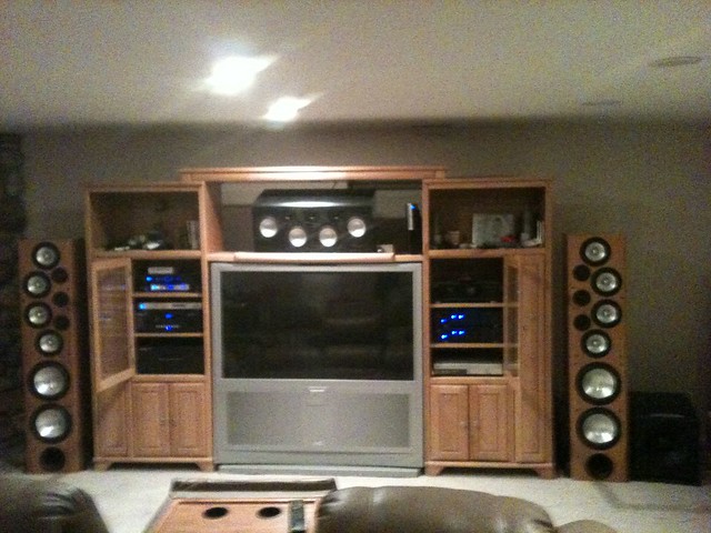

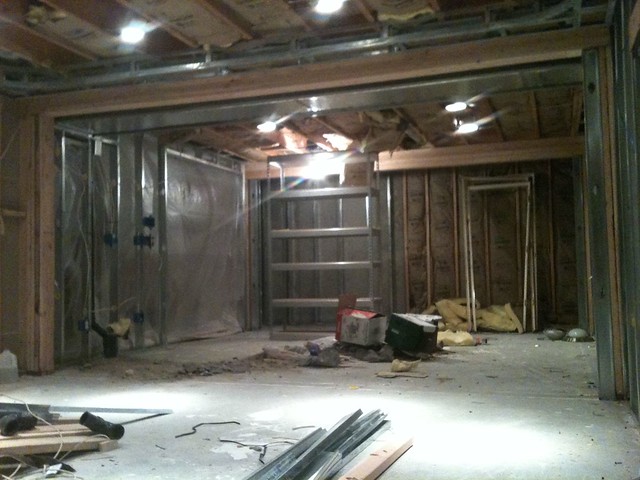

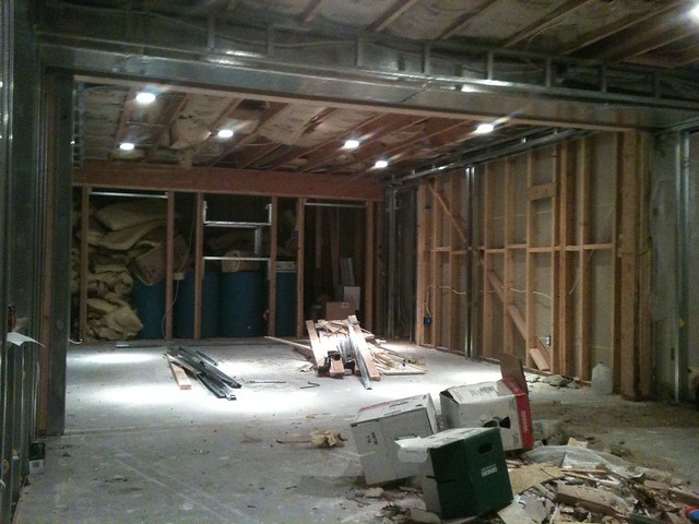

Post #5 so I can post a picture. Sorry for the clutter.

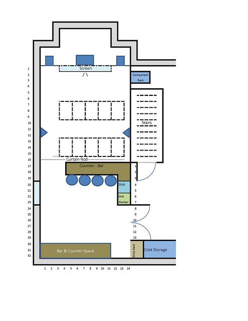

The first room is very similar to mine, but on a larger scale. Here is my current idea of a layout.
Image doesn't seem to work, here is a link.
http://www.flickr.com/photos/62669920@N03/5706088176/
A few notes on the layout:
1. The counter was possition where it is because there is ductwork and now a large beam to support the weight barring wall that was removed. It seemed logical to put the counter below this.
2. The six feet I mentioned before as space behind the screen is not included in the room dimensions I gave earlier.
3. I know the curtain will not serve as a serious sound treatment, but I wanted something movable that will cut down on the amount of "Chatter" coming from the ladies more interested in gossip on bar side during the big game...
4. Seating is given as a place holder only. I am debating between theater style seating or a large wrap around sectional. When I will use it for movies, there will be max 4 people watching. But for Football, there could be 10-15. A sectional seems more social, but would still allow for a serious home row for a captains chair. However, from what I am gathering the position of the back row in this room may not be ideal for the capains chairs?
Forgive the crudeness of the drawings. As I am a numbers geek I know excel and so that is how I created the drawings.
Thanks again for the input guys!

The room layout looks pretty good. The front row is close to the sweet spot audio wise and will also provide a very immersive 46 degree viewing angle with the 106” dia. screen. The back row is also pretty good distance and audio wise. http://myhometheater.homestead.com/viewingdistancecalculator.html
For the best image quality and picture contrast, you’ll want decently dark, non-reflective wall surfaces and good light control. http://www.avintegrated.com/lighting.html
For more social gatherings where some ambient light is preferred, the Da-Lite High Contrast Audio Vision fabric combined with a good light output projector isn’t a bad choice.

Current Setup:
The Theater Room as it is at this moment (and for the last two weeks):
Front of the Theater:
Back area or "Pub" Area:
The current designs:
AVRat
AVRat
Another tool for you: http://www.theater-calc.com/
A projector mounting position just in front of the cross-beam will work nicely. If you're seriously reconsidering the projector, I'd hold off on purchase until closer to project completion if possible.
slickrockguy
I really appreciate the great links to the sites that you guys use and trust.
This latest link, very simple yet lets me know that the riser needs to be larger than I had originally planned on. That is nice to know before hand...
Your input and links have helped me in to re-evaluating and tweek a few things so that I ultimately feel comfortable with this space.
