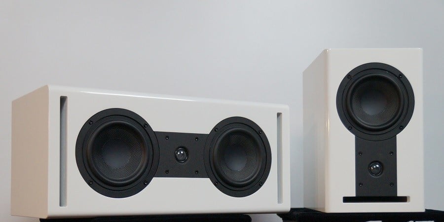

I selected a coaxial driver as the basis of the center speaker in my AV room. It was the right design approach.
