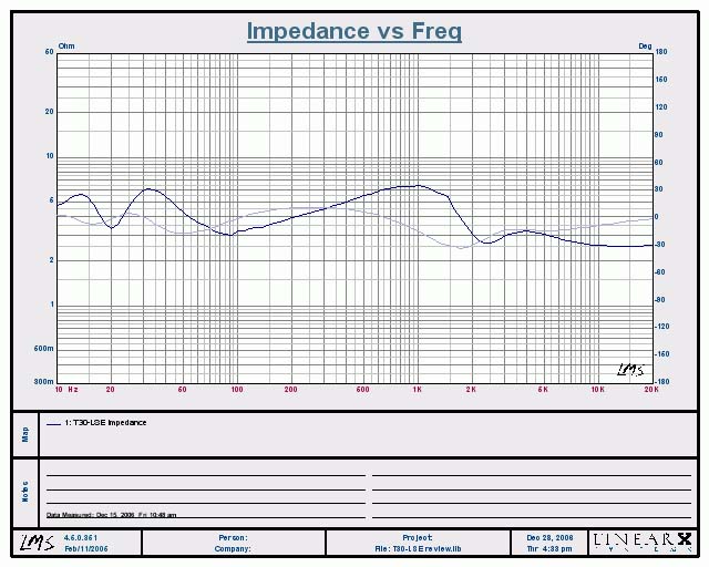

The scale of that measurement is too wide, you can't really see what is going on.
Here is a multi driver RBH speaker with a very flat impedance and pretty begin phase response. This speaker has 9 drivers so its quite a feat for such a complex design.
Impedance Full Screen Image — Reviews and News from Audioholics
I think if you click the + icon to 150% you ca see what is going on very well.
