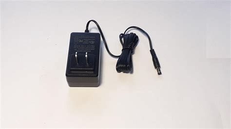

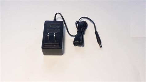

If you don't have a universal remote, buy a smart plug/outlet and use the phone app to control it. You'll still need the wall wart power supply.
The link shows a wall wart- it can be any brand, but make sure to check the screen's specs for current draw so you can get a power supply that will work correctly and for a long time.

Thanks BMXTRIX - With your recommendation I was able to get the screen up by inserting an old RJ11 connection and touching wires together. I figured out that Yellow and Black together is up, Yellow and Green is down and Yellow and Red are stop. This helps a lot especially if I can not get the or a remote to work. I am not giving up just yet on a remote. I think this idea on these pictures of a remote I bought might help. The instructions that were included were not helpful but I think I should put the green wire in the "Down" port, black wire in the "Up" port, and red wire in the "Stop" port and then try the yellow wire in the "On" port? I am not sure what to put in the "Off" port just yet. Then I would secure the transmitter near the screen and use this remote to work off the transmitter. What do you think?
Or do I need something like the last photo to give me power for the transmitter?
