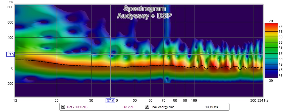

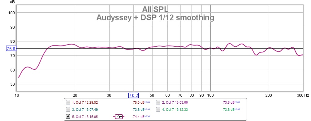

I think you discovered from your first experience I wasn't kidding when I said to budget a solid day to play around with it. I'm a little rusty and I know I'm gonna have to re-learn a couple of things. Once you get all the kinks worked out and know what you're doing its a great tool. Helped me achieve this.
That's where I'm at right now unless something changed in the last year or so. There's some heavy dsp going on there if I'm to be honest tho. I have some ideas for repositioning things to see if I can get a smoother response with no peq, then start from scratch again. I want to get as good as I can with as little filtering as possible. I might even look into moving a sub out to the kitchen behind us. I'm hoping creating a little more space for my towers to breathe will improve their bass response. I'd like to lower my crossover point, but then I lose some of my mid bass.
